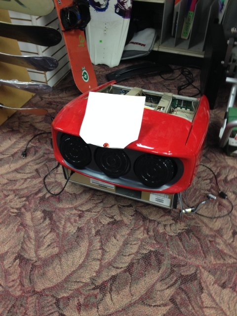

Hay to the op if you decide to remove the vision 1 case let me know as I am wanting for my vision 3 as I just changed it to a vision 1 and love the pic from it just want the fiberglass case

The vison sets used different cases for each model and the one in the pic is a vision 1 for sure

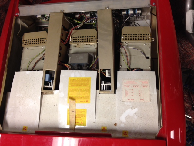

Posted: Sun Oct 13, 2013 12:50 am    Post subject: This is the actual unit..
Here are a couple pictures of the actual unit. The picture that was posted was the picture that the pawn shop posted on craigslist. The projector doesn't have tinted C elements and is not LC.

Looks awesome love that pinaferia case
FYI the cases are swappable so if you want a black case let me know and we can trade as I have a set of 8inch tubes in good shape (green 8 red and blue 9) that I want out of my way or I can swap cases
