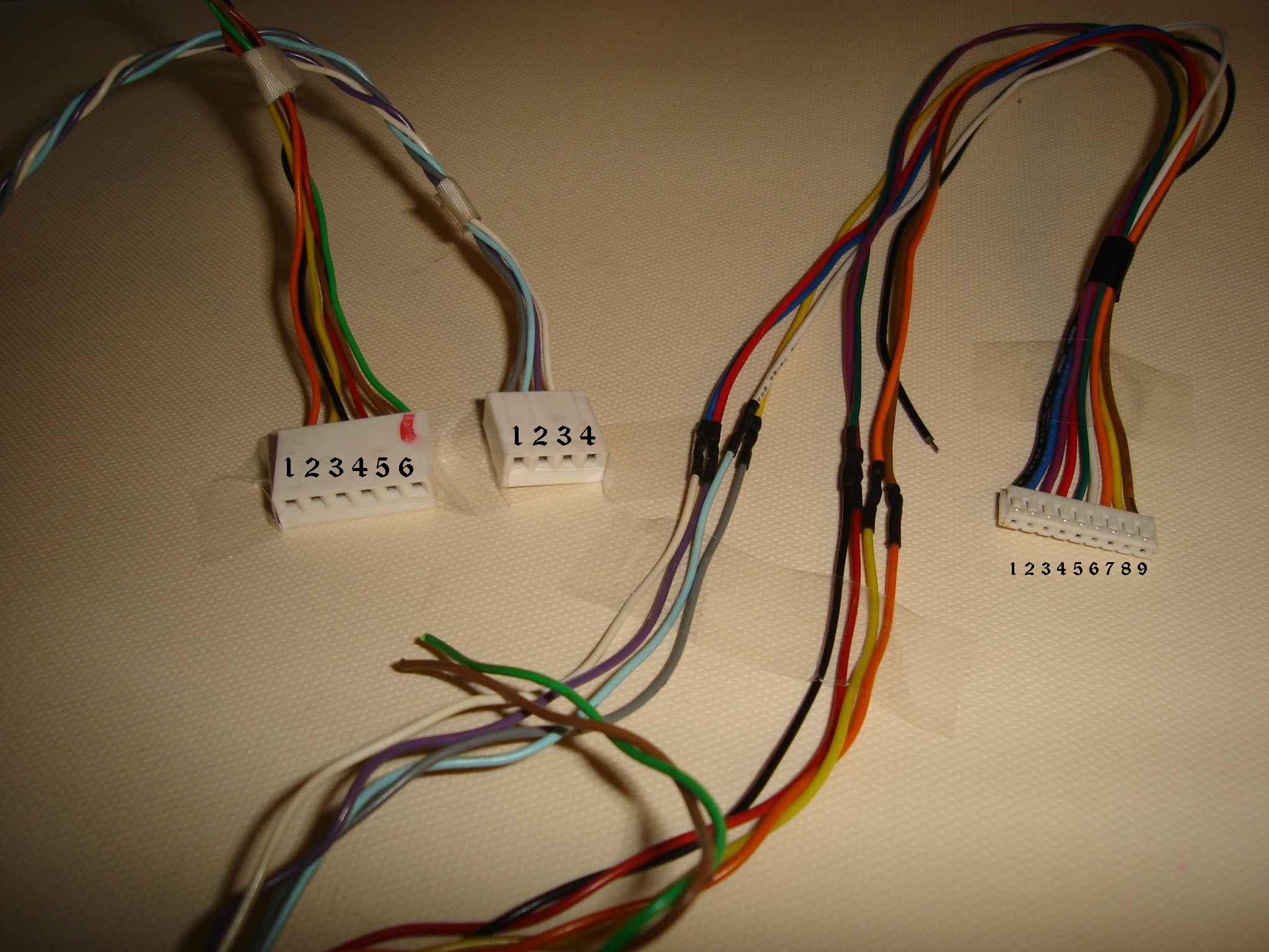

I have one of the pictures saved but I have G90 coils and have yet attempted to tackle them as I am still restoring the boards.
Hope this helps you out.
Maybe Nash still has some of the information saved?
James
Frankenyoke cable picture
 Filename:  Frankenyoke_cable.JPG
 Filesize:  236.19 KB
 Downloaded:  466 Time(s)

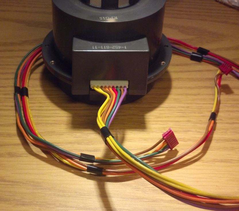

Here is a picture of one of my 1292 yokes and the wiring harness
KPG15 wire harness
 Filesize:  78.53 KB
 Viewed:  5853 Time(s)

Found this om my drive also. Is this of any help?
Frankenyoke_Cable_colour.pdf
 Filename:  Frankenyoke_Cable_colour.pdf
 Filesize:  10.17 KB
 Downloaded:  282 Time(s)
Frankenyoke Wiring.doc
 Filename:  Frankenyoke Wiring.doc
 Filesize:  32.5 KB
 Downloaded:  313 Time(s)

Posted: Thu Jul 25, 2013 12:34 pm    Post subject:
That's the same docs that I have as well but thank you for posting them. If you compare the wire colors in those docs with the picture I posted above, you can see the wire colors on my yokes are completely different.

According to the above picture you posted the wire colours in the .DOC file I posted are correct.
Sony Yellow1-Ground
Sony Yellow2-White4 on Marquee Stig harness
Sony Brown3-Red4 on Marquee Focus harness
Sony Orange4-Violet3 on Marquee Stig harness
Sony Orange5-Black3 on Marquee Focus harness
Sony Red6-Light Blue2 on Marquee Stig harness
Sony Green7-Yellow2 on Marquee Focus harness
Sony Brown8-Gray1 on Marquee Stig harness
Sony Violet9-Orange1 on Marquee Focus harness
Brown and Green on Marquee Focus harness are not used.
Unless I am missing something here it looks ok to me.
Make sense now?

bpdski
Joined: 29 Apr 2012
Posts: 54
Location: Atlanta, GA
Posted: Thu Jul 25, 2013 1:26 pm    Post subject:
Stupid me, I opened your pdf file only and not the doc file. Thank you very much, I had not found that doc file before, that is exactly what I needed! Time to get busy with my soldering iron...
