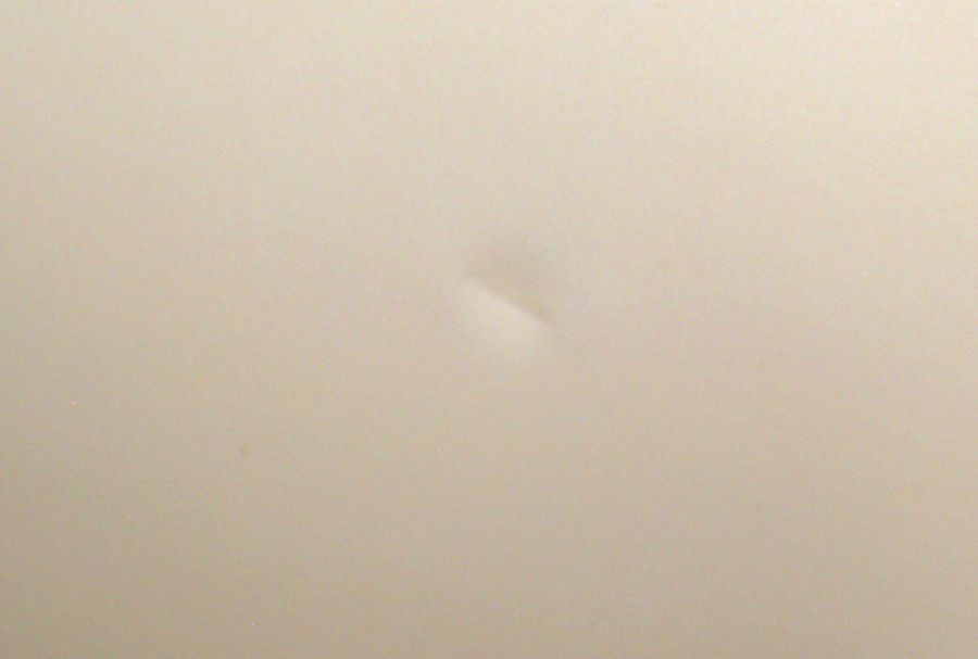

I got in last night to find, my girl friends screen damaged. A bunch of crap avalanched and put two creases and a dent in it.
Can this be repaired? Heat from a blow dryer? HELP!!
( pics to follow )
Posted: Mon Jul 22, 2013 11:38 pm    Post subject:
Dented!
 Filesize:  30.63 KB
 Viewed:  15898 Time(s)

Posted: Tue Jul 23, 2013 2:05 am    Post subject:
It'll buff out

Posted: Tue Jul 23, 2013 2:21 am    Post subject:
IMO, the wrinkles will relax themselves out over time. If you use heat I would be careful as to not melt the coating on the screen surface (hair dryer better than a heat gun!). The ST130 seems to be pretty resilient stuff.

Posted: Wed Jul 24, 2013 6:48 am    Post subject:
Any of us could suggest a remedy, but it would just be opinion, and could be just as likely to damage the screen as to improve it. I surely wouldn't just grab a heat gun or even hair dryer without first talking to somebody. Just call Stewart, ask for customer support, and ask what to do. 800.762.4999
Posted: Wed Jul 24, 2013 1:36 pm    Post subject:
How big's that dent Analog? One inch long? A foot? It's impossible to tell from the photo.
It's funny, my homemade screen (made from curtain blackout material) has been through a lot over the last ~12-13 years and I'm still using it. If you shine lights on it and look at it up close, there are a couple of small dents in it but when there's a picture up on the screen you can't make them out at all.
Do you see the dent when watching content? If it's not too bad it may be best to simply leave it alone and it may get better over time.
I'd also give Stewart support a call or email - they'd be in the best position to know what to do.

It's about an inch. Sorry should have specified. It was the end of a roll of Christmas wrap that hit it. The whole thing looked like a Rube Goldburg setup. A blanket fell, hit the next thing, somehow a random roll of Christmas wrap ended up out there when we left it was no where near there???? Weird.
Haven't had a chance to watch anything on it yet. I did notice the other two creases have lessened. Maybe this one will ease itself out too?
SC thanks for the number I'll call next time I'm here.

Posted: Wed Jul 24, 2013 5:00 pm    Post subject:
When I received my ST130 material it was wrinkled from being in a shipping tube for over a week (and it was packed very carefully). After the screen was assembled and mounted it took another 1-2 weeks before the wrinkles disappeared. I would wait before taking any action.
Posted: Thu Jul 25, 2013 6:33 am    Post subject:
I'll leave it for a month. I think the roll stretched the screen fabric. We shall see.

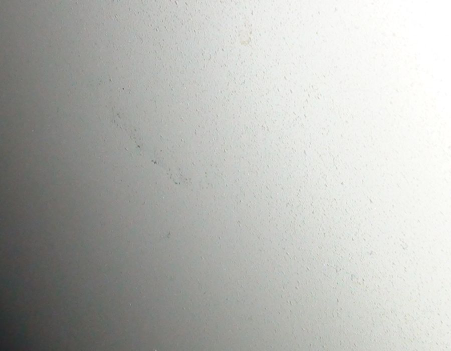

Posted: Wed Aug 28, 2013 9:57 pm    Post subject:
OK month later ( more or less ) and here's what we've got:
 Filesize:  57.04 KB
 Viewed:  15636 Time(s)

Posted: Wed Aug 28, 2013 10:37 pm    Post subject:
Looks better to me. How's it look in real life?

Posted: Thu Aug 29, 2013 10:17 pm    Post subject:
I can only see it when I'm right up next to it. The dent it gone! Tha's just where the paper roll scuffed the surface of the screen. I **MAY** try to brush it off lightly with my finger.
CRAIG: Thank's for the info.
