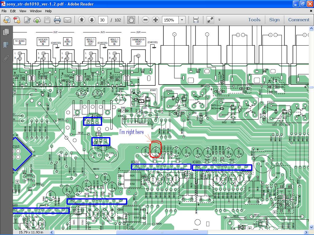

Mac, where is that capacitor located, I spent a good half hour this morning looking and I cant find it Neutral
Posted: Tue Jul 23, 2013 5:02 pm    Post subject:
Very Happy
 Filesize:  228.77 KB
 Viewed:  12230 Time(s)
Jeremy112
Joined: 28 Sep 2006
Posts: 2649
Location: Fond du Lac, WI
Posted: Tue Jul 23, 2013 8:43 pm    Post subject:
ahh it's right in front of one of those STK ICs, gotcha, thanks mac, will get back to ya with the results Smile
