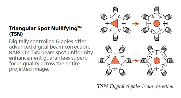

Its simply incredible. No triangles, just perfect round dots across the entire screen....

Posted: Wed Jul 17, 2013 7:34 am    Post subject:
TSN:
 Filesize:  62.86 KB
 Viewed:  9030 Time(s)

So not so crap. Better than NEC.

barclay66 wrote:
TSN:
Yep, i read that 12 years ago in the magazine that reviewed it.

The astig is better on the Barco no doubt, although the convergence system is not even close to the standard of NEC, and youre only kidding yourself if you think it is. The adjustment is not as fine on the Barco, the zones on the NEC are much smaller, and there is loads more of them. Overall, if one were to compare Cine 8 against an XG as a fair comparison of apples to apples, the XG would EASILY blow it away.
