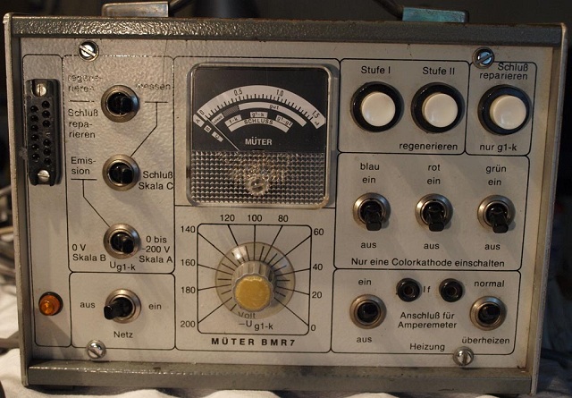

Posted: Wed Jul 10, 2013 6:53 am    Post subject:
stridsvognen wrote:
Ohh so now i need to find a old CR7000, and see if it will save my 800 hour 9" Panasonic tube, and 8" green from my Marquee machines.
Hello Kurt,
I can borrow You a CRT Analyzer/Restorer for Your purposes. It's one like these which includes short repair too:
 Filesize:  143.63 KB
 Viewed:  9617 Time(s)
Posted: Wed Jul 10, 2013 8:54 am    Post subject:
That looks like some old solid German gear you got there..
You had any luck saving some marquee tubes with that one.?

Until now I have been lucky. None of the tubes I have show any symptoms of grid shorts. I have used a newer version of this device (BMR 95) in order to determine the emission curves (G1 voltage vs. beam current). This gives You a first idea of the tube's linearity (phosphor characteristics is another factor of course) and of the tube's system wear...
Edit: The usage of the BMR 7 is quite straight forward. I could talk You through it as soon as You have it.
