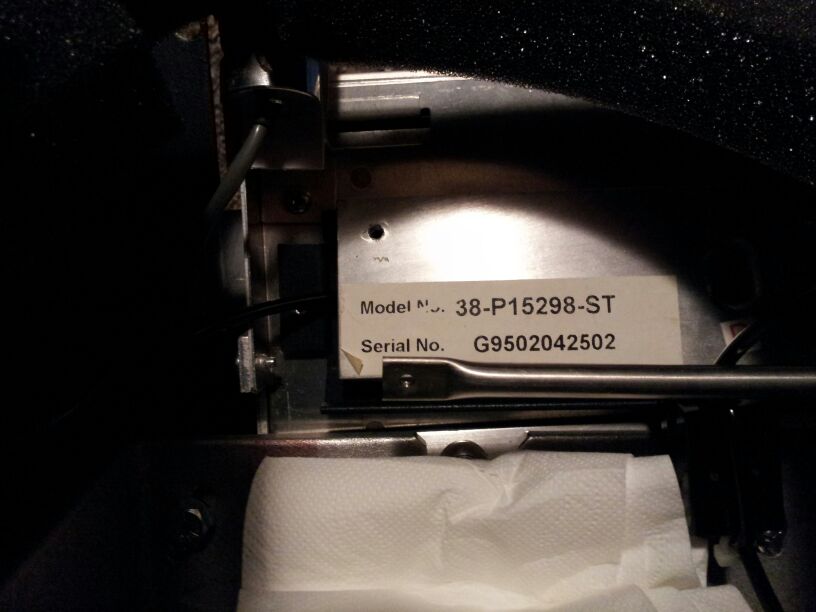

Morettii
Posted: Tue Jun 18, 2013 7:34 pm    Post subject:
I found -ST in my serial number, so does that mean that the pj has got the P43 Tube for 3D?[/img]
 Filesize:  49.2 KB
 Viewed:  9138 Time(s)
Posted: Tue Jun 18, 2013 7:38 pm    Post subject:
Probably
It would have shipped out of VDC with P43. You can take the top plastic cover off of the green tube and look for a label.
P43 is a bit more pastel than standard green, it will tend to flicker at lower vertical rates and it will output less light.

Tim in Phoenix wrote:
Probably
Damn, that sounds not so good for me Sad

P43 is a Phosphor, PT22 is a tube version. Both eight and nine inch tubes can be P43 green.
Standard green is slower decay, that makes it seem brighter by duty cycle but standard green is too slow for 3D vertical rates, typically 96hz, where the left eye/right eye refresh will ghost unless P43 green is specified. Red and blue are deemed fast enough for 3D, so P43 is only found in green tubes.
