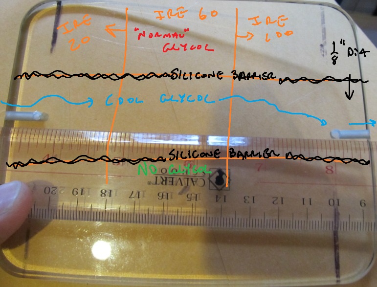

To probe this, I am taking a 7"ES tube and am proposing two simple experiments.
Experiment 1
Remove the glass plate and the optical fluid (glycol). Display three distinct vertical zones of 100IRE, 60IRE, and 20IRE while monitoring the surface temperature with a thermographic camera over time until a steady-state is reached OR a significant temperature gradient is established and I'm scared uneven thermal expansion will implode a tube. It may be hard to calibrate the camera well, but it will show relative trends pretty well. I'll place two surface mount, low-thermal mass TCs on the tube face at the coldest and hottest expected zones. I will photograph the tube surface before/after and perhaps intermittently during the trial. Replicates are unlikely to be performed.
Experiment 2
(see the picture and sketch below)

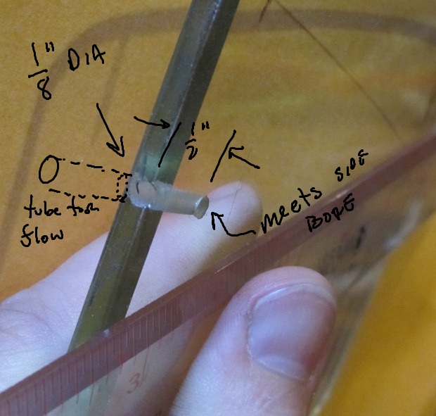

I have already used a diamond drill to drill a single 1/8" Dia hole into both edges of a tube glass plate. The holes penetrate about 1/2" in from each edge. Two additional holes were drilled orthogonal to the face, meeting the sides hole and thereby forming a letter "L" channel. See the picture below. I am bonding a thin-walled stainless steel tube to both holes to allow chilled glycol to be pumped through a section of the tube face. By putting two parallel, horizontal strips of silicone along the tube face, I will create three horizontal zones: One with no glycol on the bottom, one with chilled glycol, and one with standard glycol on the top of the tube. By using the same IRE pattern above, this will create 9 different zones on the tube face. I'll monitor the impact on tube burn-in periodically with a standard camera AND will place a surface mount thermocouple in each of the three zones. The cooled fluid will enter on the 20IRE end such that it will remain as constant in temp across the three zones as possible.
I need to estimate the power/area maximum for IRE 100 at a given drive setting somehow to get an order of magnitude feel for what might happen. That is, if a single tube gets ~60 watts at full 100%IRE, max drive, then 1/9 the area might be 6W/sector, with a sector being ~2 in^2 => 3W/in^2. That is a lot of energy...not sure how much is light and how much is heat and/or if the ratio of light:heat has a max at which more driving only heats the tube face. Anyone know the current pulled by the tubes and at what voltage during max drive and full white...?
In conjunction with all this -- IF the tests clearly show cooling the tube face reduces the rate of tube browning, I will create a model of the system in COMSOL that can allow for simulation of the heating AND of how flowing glycerol would cool the tube face in order to minimize stagnant zones/hotspots.
Thoughts?

Modified glass plate with markings showing the zones that would be present during testing.
 Filesize:  148.92 KB

Hole I bored into the glass, forming an "L" shaped tube to allow flow of glycol.
 Filesize:  104.79 KB
