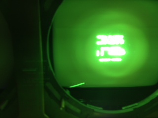

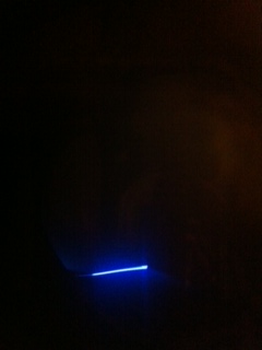

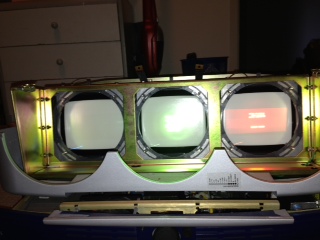

ive had these weird streaks at the bottom of each tube and are all identical??? They were there before when i had the bad splitter so i can rule that out... when i use the internal masking setting they do go away but im a little concerned as they scan off the phosphors...Ive attached some pics and help would be greatly appreciated as im still quite a newb...
hard to see in this pic but the all do the exact same streak

Posted: Tue May 28, 2013 12:24 am    Post subject:
That's the AKB line, or auto brightness. IF it bothers you, tape over it with some black electrical tape, but usually it's well off the screen and you won't see it. All Barcos have that.

Posted: Tue May 28, 2013 12:54 am    Post subject:
WoW i thought it was a stuff up Smile ok so time to reassemble and finally get a movie out this thing!!!!!
