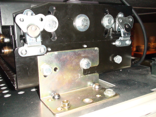

My projector is now snuggled happily up against the ceiling again, thanks to the Chief lift I got from Curt !!! Very Happy Very Happy
I didn't end up using/needing the original XG bracket at all; instead I slightly elongated the four bolt holes on the 4" L-brackets that the factory bracket attached too, to get the spread a little wider apart - enough to bolt the Chief bracket into (the part that the cable loop fastens to/through).
After that it was a matter of re-working my Unistrut hangers with a pair of new ones running crosswise to mount the Chief too, bolted to the original pair of unistrut bars that my old XG mount was fastened to.

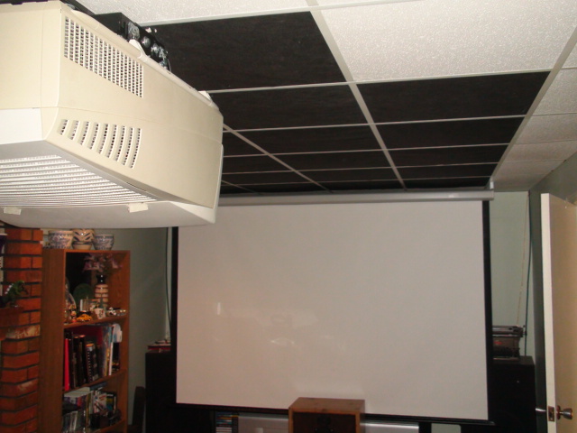

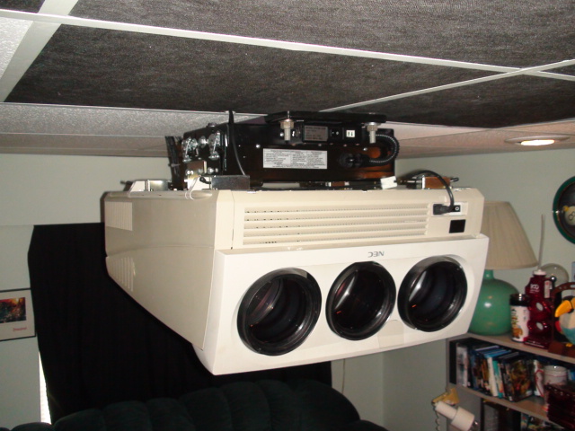

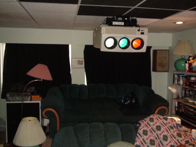

As promised, some Photos of my XG on the ceiling of my HT , and close-up of the Chief Lift to XG angle bracket attachment... in addition to elongating the bolt holes I had to slightly notch the upper edge of the XG bracket to clear the locking tab mechanism.
Cheers!
