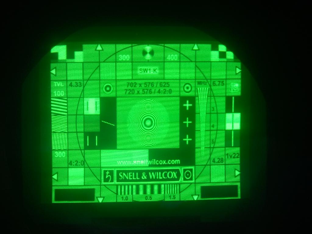

Posted: Mon May 20, 2013 6:20 pm    Post subject:
Here a picture. Sorry for the quality.
As you can see there is alot of unused fosfor left.
I can fill the tube from top to bottom with the green knops nearly by the edge, but not from left to right. This knob is already completely turned to the right. Would it be better to use the internal test patterns?
image 1
 Filesize:  87.51 KB
 Viewed:  6106 Time(s)
Posted: Tue May 21, 2013 12:20 am    Post subject:
Im interested to see the whole projector for a couple view in the light, cause it doesnt look like a 1031 in that image unless youve left the lens frame on the chassis. The fact you say youre adjusting pots means it probably is, but i want to be sure what you have is what youre being advised on.
Too big there, you should make it abit smaller. You will need to reduce vertical size to make the image 16:9.
Whatever machine it is, the scanlines are pretty tidy at 576p!! Wink

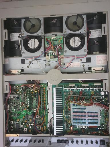

Here the pics from this heavy dude Cool
Lenses are SD187 types.

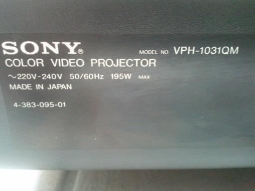

Nameplate ;-)
Inside
 Filesize:  57.35 KB
 Viewed:  6084 Time(s)
Posted: Tue May 21, 2013 11:38 am    Post subject:
Cheers mate Wink i had to be sure!!
Tubes are SD187, lenses i cant see what they are, will be Delta of sorts, i wouldnt think they will be TAC-4 but could be...

Hi Case,
It's a 1031 allright Wink also found the AGC switch

Posted: Tue May 21, 2013 6:59 pm    Post subject:
Move them all to their central points Wink use the width coils to widen the image, use an insulated allen key.
