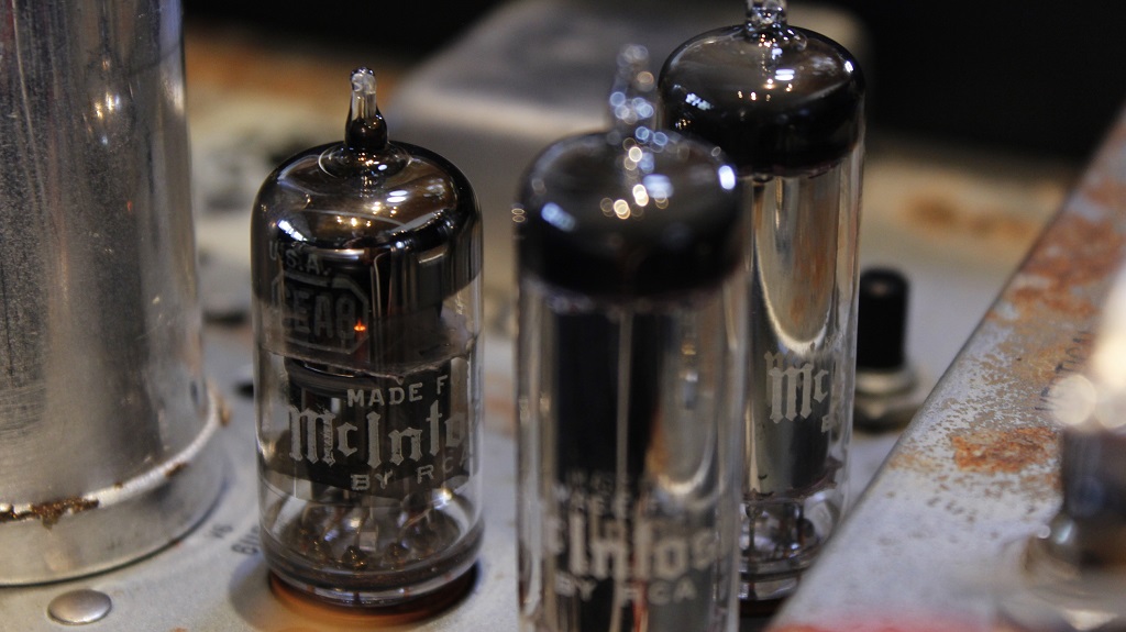

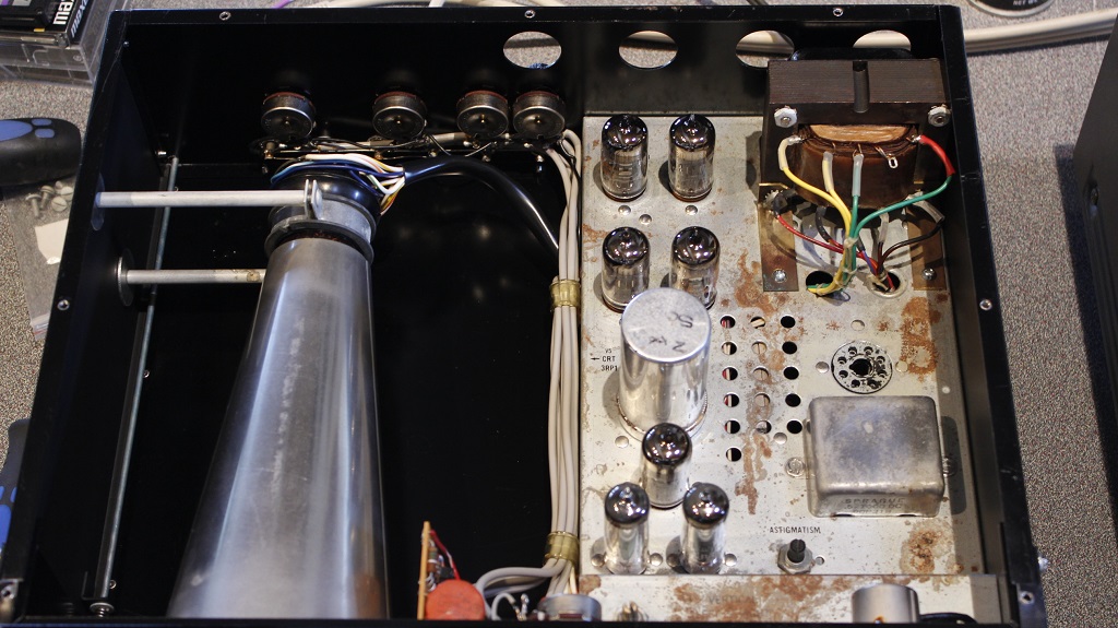

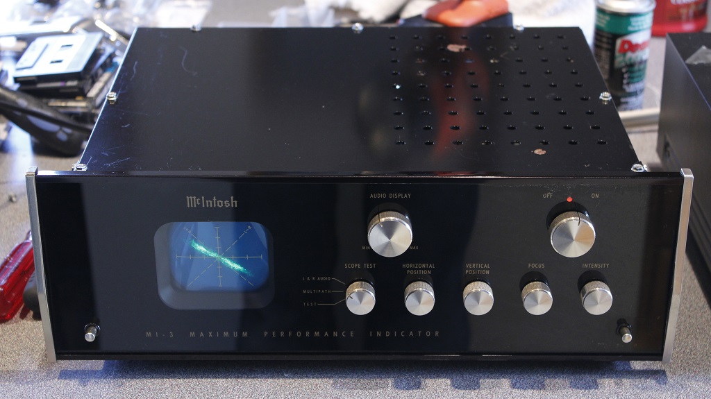

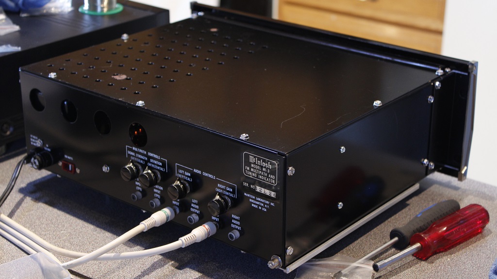

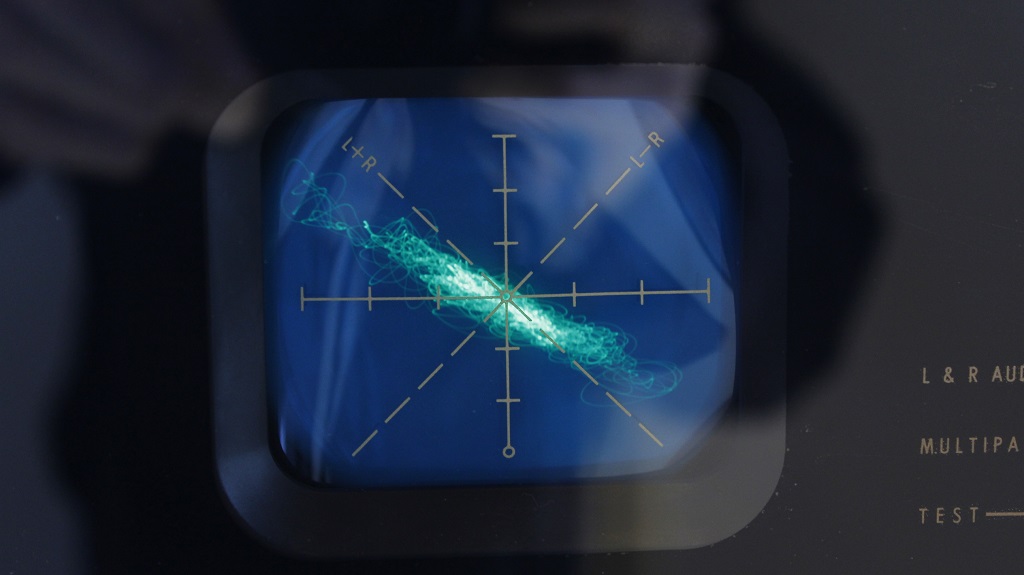

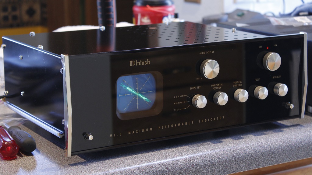

Thought I would share this project because its an interesting item. This is a McIntosh MI-3 Maximum Performance Indicator Oscilloscope. It is supposed to help one with fine adjusting of FM reception to get better signal deviation & quality from FM. It can also be used as a scope, or as I call it "Vintage Media Visualizer."
This particular scope was in pretty rough shape when I bought it. Surprisingly, when I first turned it on it worked, but I had a hell of a time adjusting the wave on the CRT because the controls were so bad. Either way, it was quite impressive to see it work considering the inside, and outside were caked with layers of filth and there were enough dead bugs jingling around inside of it to make a musical instrument.
I finally got around to it this week since I just finished up the receiver many of you saw in the buy & sell here. Since starting, I have managed to get all the pots deoxed & lubricated, which made the biggest electronic difference in the unit. Completely disassembled the entire unit to clean all the wires, tubes, black chassis as well as the tube chassis (as much as I could since there is lettering on the tube chassis & the rust on it was near and on some of the lettering). I cleaned the CRT up & readjusted the astig (yes, this little guy actually has astig, which is more than some CRT PJs can say!) as well as the static position adjustment. I also repaired the black paint on the glass panel as a lot of it had bubbled and peeled off from the glass face. Aluminum knobs all cleaned up as well.
I didn't bother replacing any capacitors in this unit since the few that are in here read fine, and the ones inside that you cannot see in the photos are mylars which checked out perfectly.
All but 2 of the tubes are the original "Made for McIntosh by RCA" tubes, the replacements that are in it are RCAs, but I guess I can't complain since I have 5 of the 7 original tubes anyway, and at least the replacements are the same brand as the originals Smile
The one thing I have been wondering is, because you input sound into it, I am wondering if the sound that you output from it sounds any different because of the tubes? I haven't spent much time testing this out, but it wouldn't surprise me if it affected the sound a bit since it has to be in the signal path if you want to use it, and because its transistor free Smile
Anyway, all that's left is to refinish the top and bottom covers, and new gold plated RCA jacks, which I have ordered the same ones that McIntosh used on my MC2102, as these are very similar to the old ones for internal connections, and they are extremely high quality. As for the rusted tube chassis, I hope to find one of these for parts that has a nice tube chassis so I can swap it out. Afterwards, it should be a 9.5 out of 10 unit.
For now, heres the part everyones waiting for, these are pics of its current state of restoration, almost done, just needs what I mentioned right above done to it and it will be complete. Enjoy the pics! Smile
