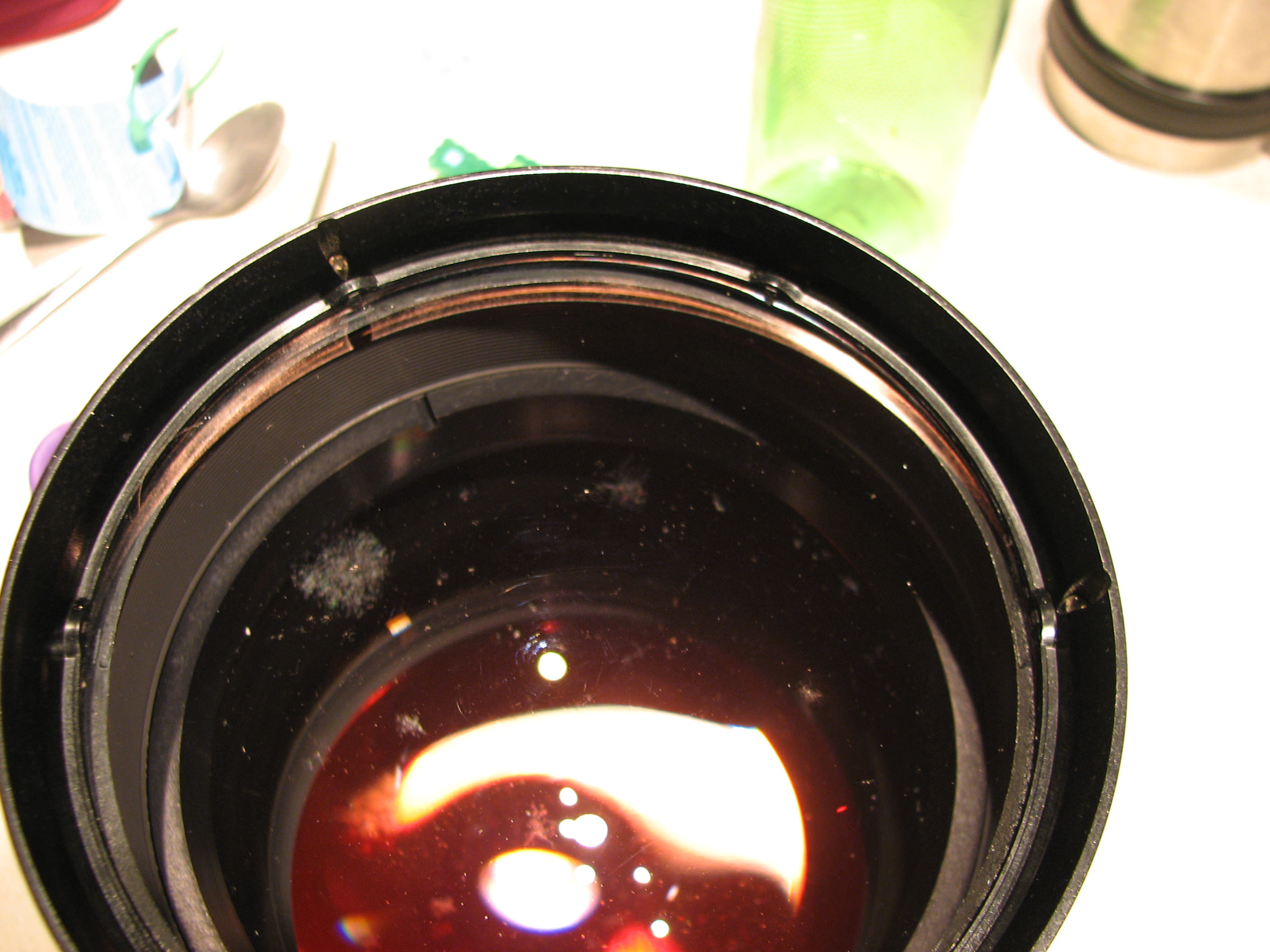

Posted: Mon Mar 25, 2013 9:13 pm    Post subject:
Is this what it looks like ?

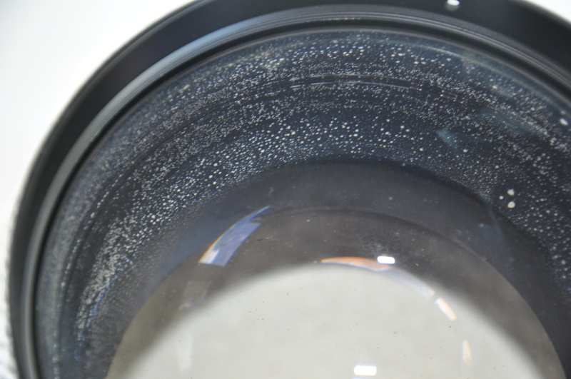

Untuned
Joined: 03 Dec 2011
Posts: 93
Location: Pooler, GA
Posted: Tue Mar 26, 2013 2:55 am    Post subject:
I'm not sure I was able to capture this well. You can see a crystalline at 10 o'clock, and a smaller one at 1 o'clock with a smattering of other ones. With the pj on, it looks like there is a ton of dust particles also.

Posted: Tue Mar 26, 2013 3:06 am    Post subject:
Google image search for 'lens fungus' and see if some of those images don't look exactly like yours. At some point, your HD-144's were probably in a dusty environment, then probably in a damp environment (basement, warehouse, etc.). The spores grew and voila! Fungus.
