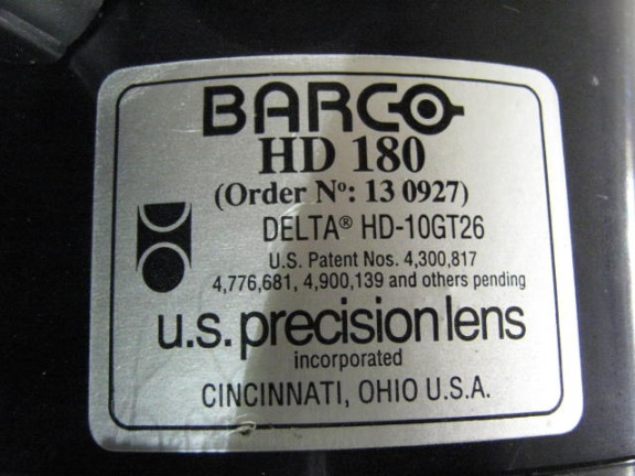

Just received a pic of the lenses, its HD 180, what do they compare to in Marquee World.?

HD-180 it's a Barco labeled HD10-GT26, optimized for large screens (it provides the best performance on 20 feet diagonal screens).
Screen width between 74,4 and 240 inch.
Throw distance between 115 and 370,1 inch.

74,4" wide will be fine for my 90" and 110" 16-9 screens. Very Happy
