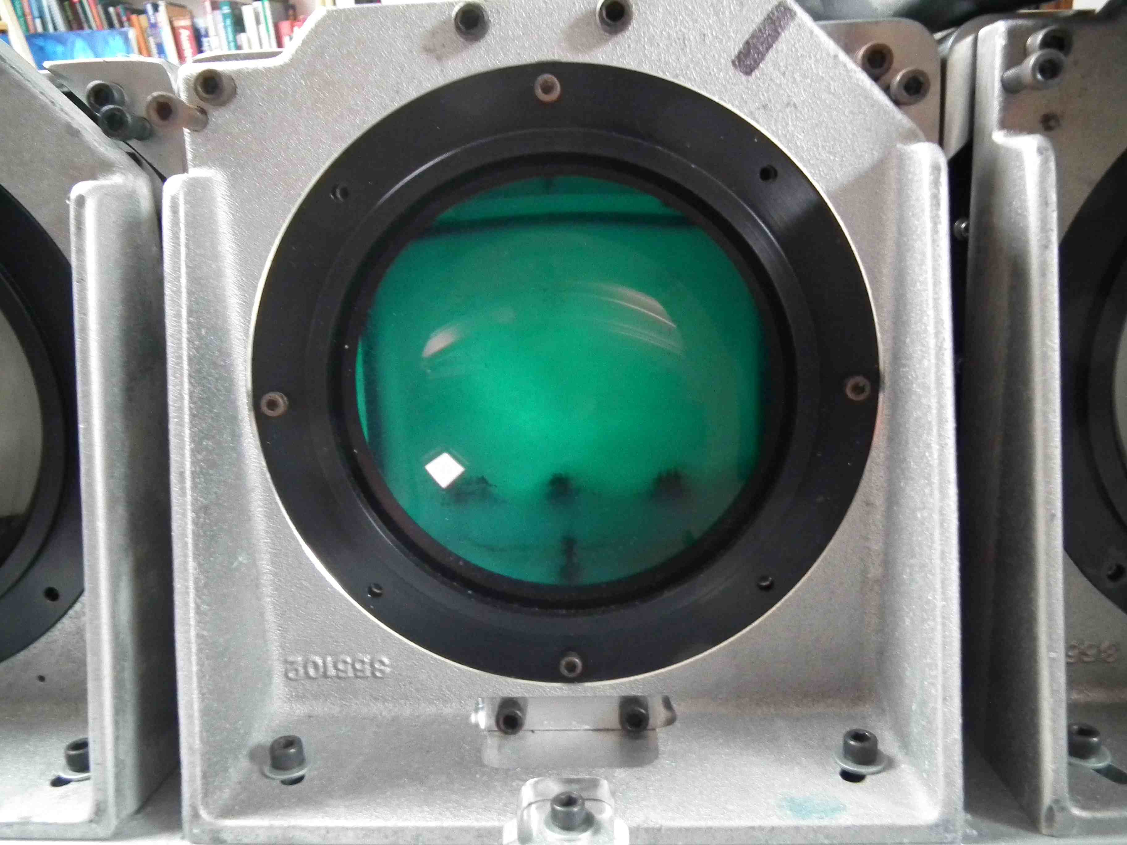

- fungus on the green tube (see photo) : not a big issue, I already planned to change the glycol on the three tubes (also have to install a red C-element)

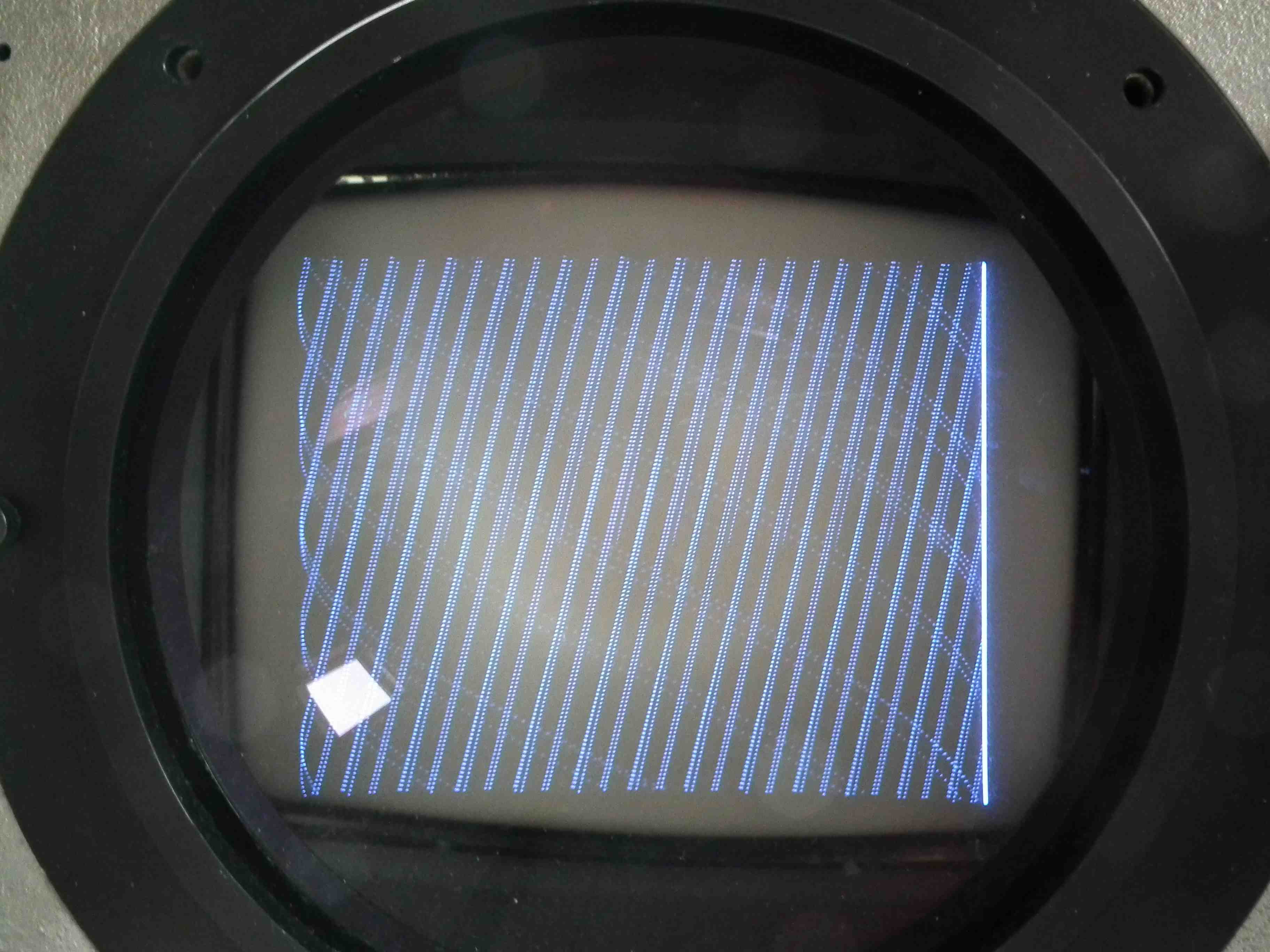

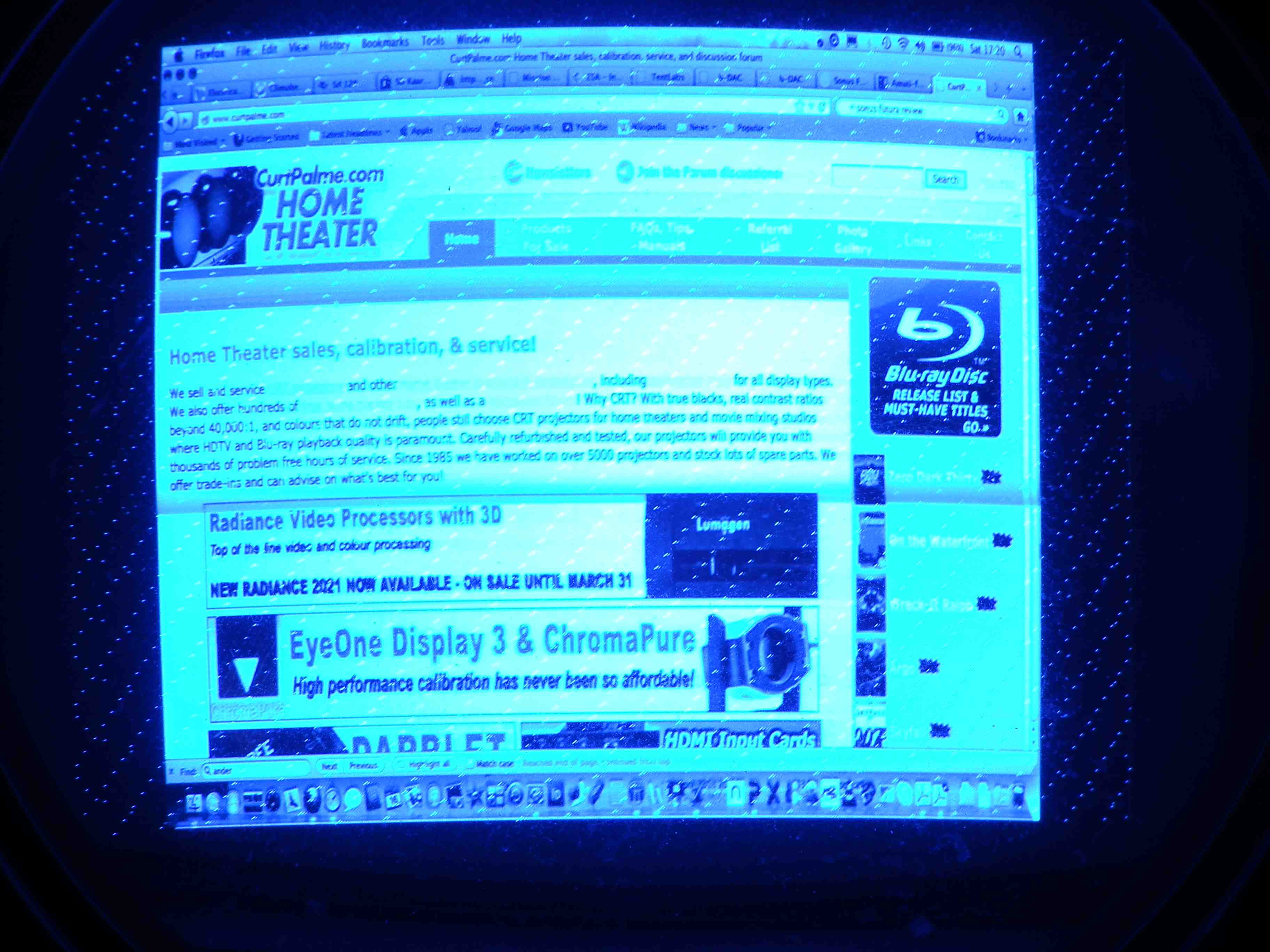

- retrace lines (and a vertical line when no video signal applied - see other photos) on the blue tube only : before I start swapping boards, I will appreciate any hints

The dots on the blue looks like a CLM problem to me, try to reseat the ICs that are in sockets, that could help.

The Fungus could be a warning or more issues. Corroded Aluminum. I say this because its very black, which means the aluminum is being eaten away. So you might have to remove the bellows and paint the housings with Epoxy paint( VHT brand).

looks like a grounding issue on blue, see if the connector on the vim makes proper ground (cracked solder perhaps) and make sure the connection on the neckboard isn`t oxydized and is firmly attached.

For a quick check, I swapped the CLM with a spare one, but lines were still visible. I will now check the cable VIM to blue neckboard, as advised.
The fungus in the green chamber is indeed the bad news - I will have to use my last spare bellow to fix that. AFAIK, when you open the chamber the bellow gets always damaged. By the way, I have this glue (RTV black instant gasket) for the bellow and C-elements. I think it should be ok, if not a bit of an overkill.

put the rca cable from green on the blue neckbard and if that doesn`t help swap green and blue neckboards.
