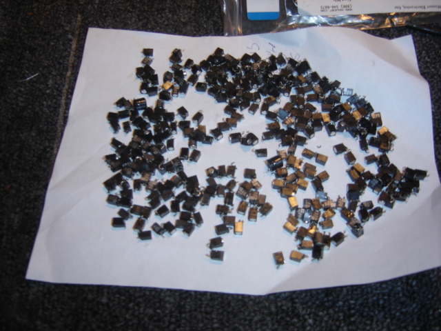

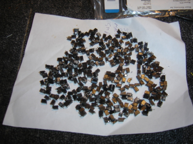

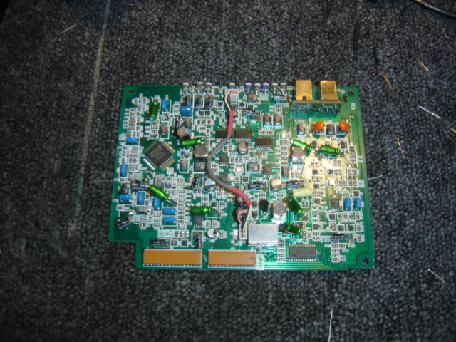

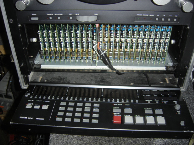

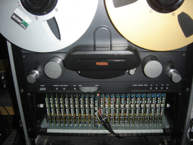

Check this out. I just spent 12 hours recapping 12 channels of this 24 channel Fostex reel to reel. Quoted the customer $100 per channel, and he only wanted 10 repaired. I've recapped 12 channels, but ran out of caps on the last two, so I'll let him know those are only 1/2 done. He only wanted 10 recapped anyway. I also removed leaky caps off the remaining boards so they don't cause damage.
Seems like this is a very common problem in these G24 Fostex's. Not many around, this is the second one I've seen, but I guess the electronics run really hot with all the boards stacked next to each other the way they are.
Funny thing was, after I recapped the boards, only 3 channels showed audio output on playback, although all passed audio from the line input to output. After scratching my head and doing some signal tracing, it seems that someone had gotten into the trimpots and turned the output ones to 0 for the playback. Then only 4 VU meters were working. Ditto for the meter gain controls. Bastards!
A good learning experience, as the G24S service manual that I got was very similar electrically, but almost all the components had different part numbers on it. That took 1/2 hour to figure out.

Anyone want bad caps????
 Filesize:  141.27 KB
 Viewed:  7954 Time(s)
 Filesize:  144.42 KB
 Filesize:  151.01 KB

24 channels crammed on top of each other
 Filesize:  152.85 KB

1 preamp board, post recapping. Some caps are larger than the originals.
 Filesize:  151.52 KB
