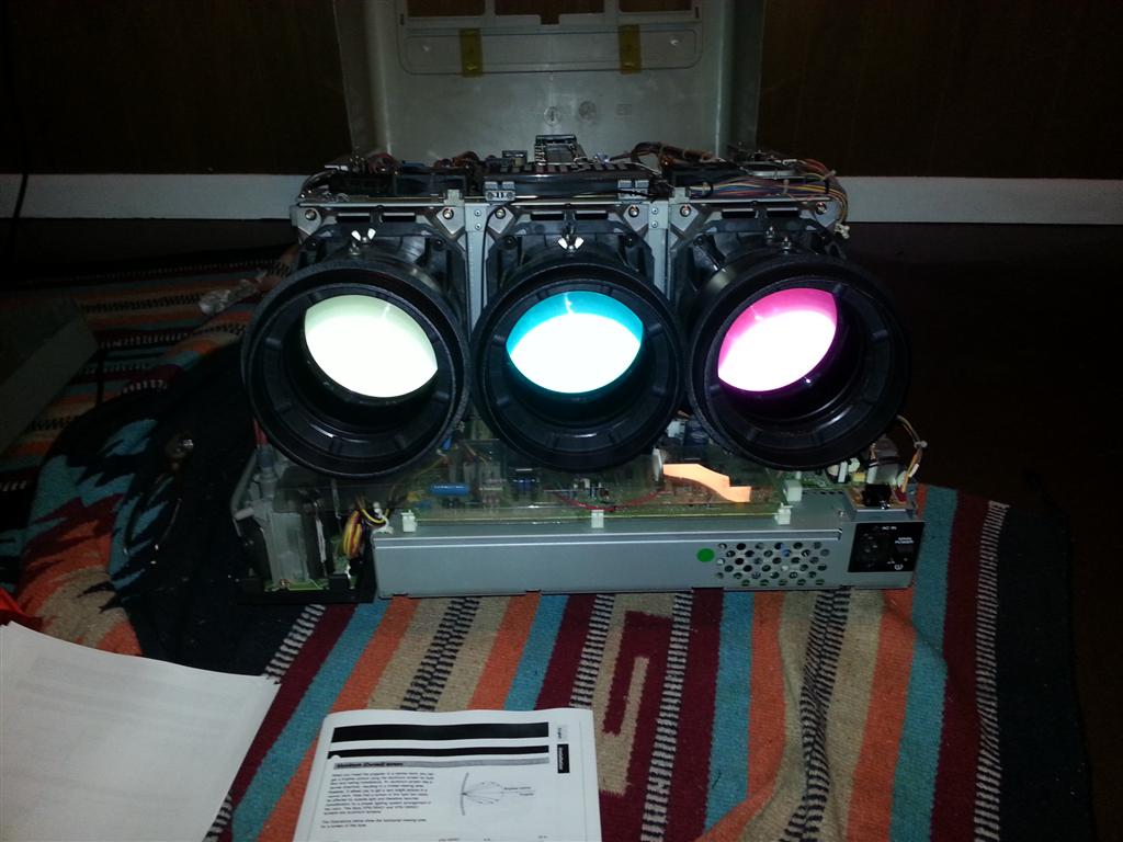

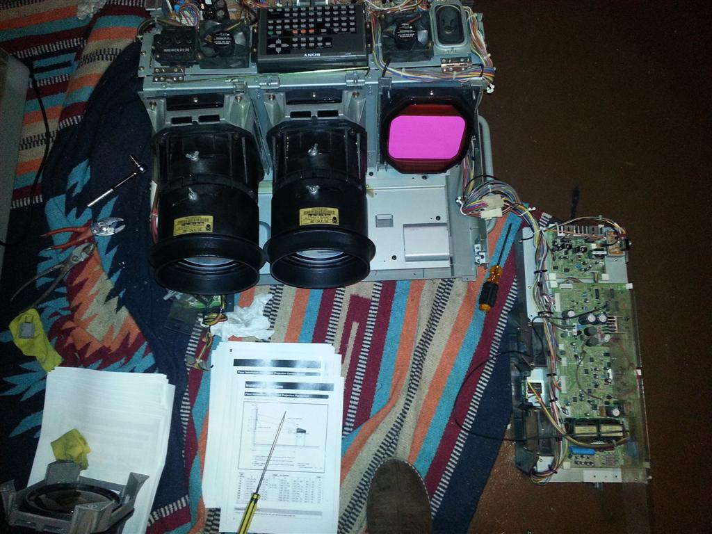

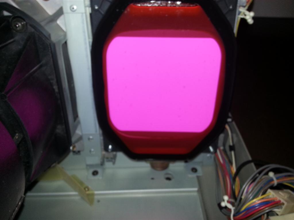

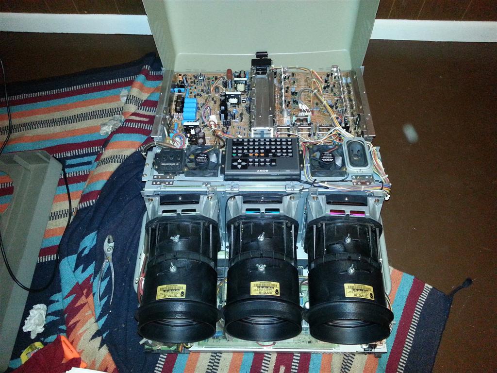

Here are some pictures. Still working on removing blue tube. PITA! Will post pics of it tomorrow.

Be sure you clean the back of the lenses along with the tube faces. That air gap, esp on the blue tube gathers dust like crazy, causing poor focus and massive haloing.
