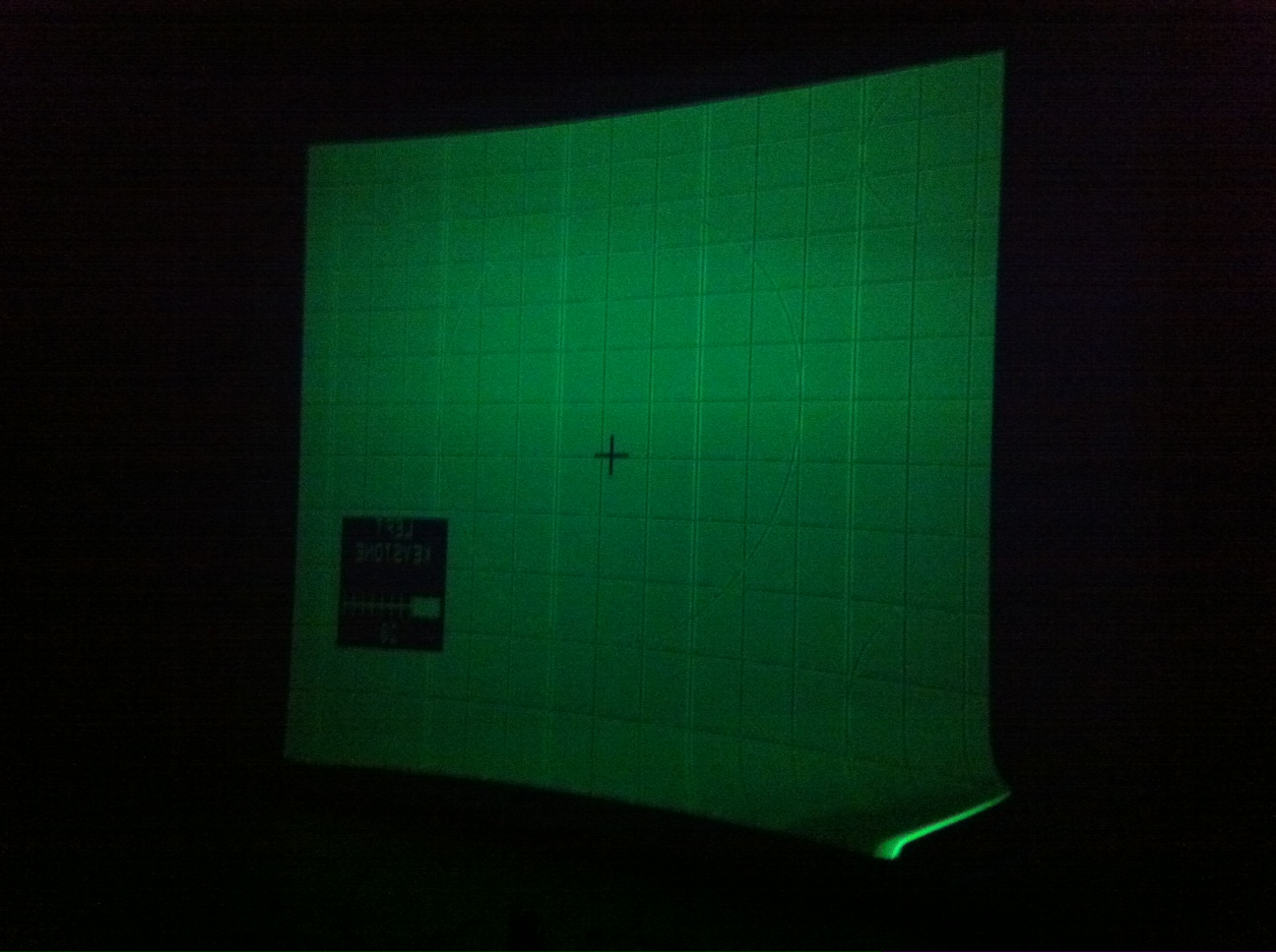

Hello. Can anybody tell me what's going on in this set up? When I use the keystone control the lines on the opposite corner start to 'fold'.
The input is component from a DVD player.

so the input is what resolution? 480p, or upscaled?

The output is from Pioneer 7300 DVD player and using the inbuilt line multiplier to increase to 625.
I am only having the problem when reversing the scan for Rear projection.
Posted: Thu Feb 28, 2013 2:35 pm    Post subject:
You probably haven't flipped the convergence connectors. You're driving one of the convergence parameters too hard causing that foldover. Sometimes the convergence driver or output board is bad, or the deflection board sending the drive signals to the convergence driver board has issues, but that's rare.

Posted: Thu Feb 28, 2013 2:38 pm    Post subject:
No I haven't. I'm going to try now! Thank you.

Posted: Thu Feb 28, 2013 2:54 pm    Post subject:
Sorted. Thanks so much!

Posted: Mon Mar 18, 2013 8:49 pm    Post subject:
BTW, I was working for 4 hours on a 708 today that showed a similar issue, but the V lines were shaking, and the key and pin had limited effect. It is an issue on the power supply board. I haven't narrowed it down yet, but replacing it brought everything back to normal.
