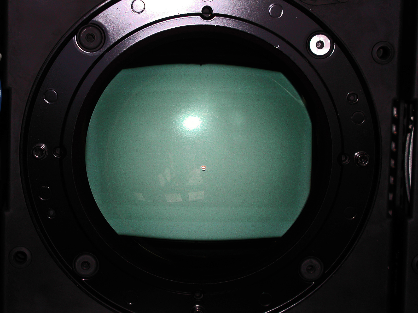

How would you rate my green tube wear? Curt and Craig have always posted that the G90's are tough on the Green tube. How is it looking for 2182 hours..
Posted: Wed Feb 27, 2013 2:10 pm    Post subject:
Looks good, and is indeed on the light side of what I've seen for G90s at 2100 hours. I'd say the green that I had here out of an 800 hour set was about the same. Am going to put a tube almost like this one into the G90 that's going on my ceiling this weekend. You're good for another 10 years.
Keep in mind, tube wear is directly proportional to your contrast settings and how well the projector was set up originally based on throw distance.

The original owner had a 120 inch diagonal screen. He said that it was set up as the 120" setting that are in the manual. It looks like machine was set up pretty good. The raster setting aren't bad.
It's also highly dependent on what you watch... If you watch a lot of space movies or "dark stormy night" movies, you won't get nearly as much wear as if you watch a lot of Ice Age or snow skiing videos. Wink

I see two slight wear patterns, I would imagine you could fit a 16x9 image inside of them, depending on your throw distance.
I did a quick adjustment in Photoshop so you can see it better.

Kellener, Thanks for the Photoshop pic. My screen is 109 inches wide and 60 inches tall. Right now I have the G90 144 inches away from the screen. I think that I need to move it towards the screen.

Where ever the previous owner set the contrast, you should turn it up from there. At that rate of phosphor decay, you will run out of emissions before you burn through the phosphor. You may as well get some more enjoyment out of that G90 with higher contrast.
Move the projector forward until you are up against the original wear pattern. That will be your ideal throw distance.

Interesting as we normally only seem to talk about phosphor wear how long should good tube emissions last on EM tubes??

Well, the G90 is unusual because it can push really high contrast settings and still maintain focus. If you increase contrast you are increasing the emission. Usually I can get 12k - 15k hours out of a green tube in a G90 (as long as the projector doesn't get relocated).
I've posted the photo several times here. I have a client in SF whose G90 has 17k+ hours on the tubes; original owner and original location. On the last calibration I set his green gain to MAX and his contrast to 95. The projector still looks great; bright (13 flt), and in focus. He has moderate wear on the phosphor, but at this point we won't be able to balance the grayscale on the next go around.
I hate pulling out tubes with light wear but that have low emissions...
