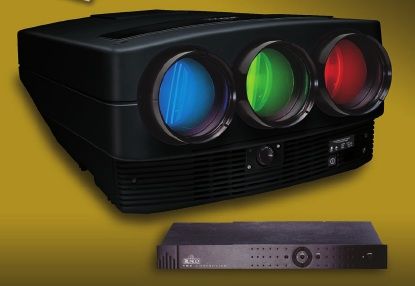

Hi guys I wanted to ask your opinion on something. I am new to the CRT projector world. I setup plenty of newer LCD and DLP projectors because we have a custom home theater installation company. One of my hobbies hobbies is collecting and watching laserdiscs. I keep hearing how well laserdic look on a CRT projector because they are both analog display items. I have been looking around locally for a CRT projector and trying to find one that is worth messing around with. I don't want to ship one because they are so big and heavy. Long story short there is a gentleman near me that has a Runco DT-940 along with the Faroudia LD200 line doubler. He is asking $400 obo for it. He says it works very well and was recently serviced. My question is is this a decent CRT projector to start playing around with or should I look for something else? Is that a fair price or should I offer less and if so what would be a good starting point to offer. I know it has 7" lenses and will do 720p and 1080i according to Curt. Any help or advice would be wonderful! I would love to find and get a Barco 1209 but my wife would never allow that behemoth in the house lol.

That's a Barco 700 series. If you really want to line double laser discs, then it's perfect.
If you also want to watch true HD sources then I would keep looking

Paul, you've gotta read that FAQ link that I sent you. A video signal (composite) is only 480i, as low a resolution as it gets. In order to display a higher resolution, you'd need a line doubler or a scaler. The rare BArco projector has a built in line doubler or scaler, but none of the Runcos did.
With your laserdisc collection, you might actually be able to use the Faroudja, but I think a newer model DVDO or Lumagen may be a better processor, esp. if you get one that scales up to 720p. A doubler is only 480p.
I still think the price the seller is asking is too high, as I guarantee the set will have some sort of wear on the tubes. New tubes are no longer available, and were $600 each when they were.
Put it this way: I sell that projector with mint tubes for $800 with a warranty, so if that set shows any wear, you'd almost be better off buying a known working set from me.
