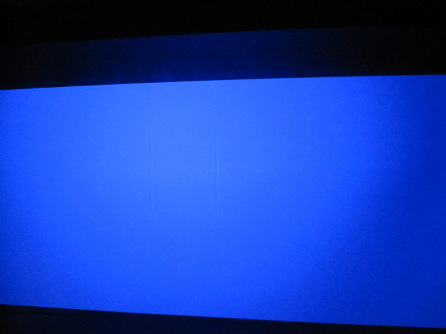

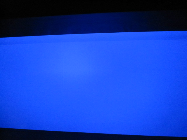

One:
I have problems to capture this. I have a discoloured circle on the blue channel. The more I focus the blue tube, the more the circel moves to the center of the screen/active phosphor area. If I defocus blue to much for usage, the darker circle moves outside the screen or to its edge. If forces me to defocus blue a lot, and gives me probably the first time a good white balance. I live with this for some time now, as it is only visible in a very bright sceen (like tube masks on the edges of a screen). It started (educated guess) when I did this: http://www.curtpalme.com/forum/viewtopic.php?p=350608&highlight=#350608. Well, the focus board or HDM dropped that day about 10 inch...
No contrast modulation board installed, all resolutions.

Posted: Mon Jan 28, 2013 12:30 pm    Post subject:
Hello
Blue always does that, it darkens when it is most focussed. Maybe try another focus yoke.

Posted: Mon Jan 28, 2013 6:49 pm    Post subject:
Also in the pic you can see the outline of a menu Box, or is it just me?

Posted: Mon Jan 28, 2013 6:59 pm    Post subject:
I see one to. Could it be an internal menu?

Posted: Tue Jan 29, 2013 7:20 am    Post subject:
Yes, seems like CRT people have good eyes. Guess that why they use CRTs...
I made the photos while changing the blue focus, so you see in the blue test pattern in the blue menu when changing the blue focus.

Posted: Tue Jan 29, 2013 9:36 am    Post subject:
Tim in Phoenix wrote:
Hello
Well Tim, a shot in the right direction!
I had the focus problems last time, after I inserted the plugs to the FGM 180 degrees wrong. On the hunt for the problem I redid Stigmators, and then again when I returned the plugs in the right position. MR. Lazy Ass did Stigmators on blue only in the center (and not very good) and about close to nothing in the edges. That results in an uneven darkening and brightening when focus is adjusted. So with careful Stigmators on blue, I have an even blue output - no matter what focus I use for blue!
