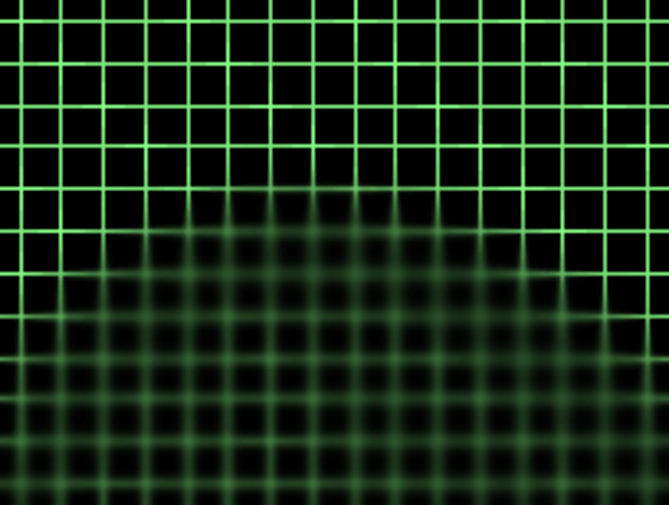

Lately i was cleaning all the dust out of my 701. After turning it on again i noticed a strange partly blur in the lower part of the green tube. I tried to visualize it with photoshop, just for demonstration, i exaggerated the problem a bit so it becomes more clear.

Is this set LC or AC? If the former it could be fungus
Posted: Fri Jan 18, 2013 8:47 pm    Post subject:
Very much fungus. Common problem with these sets . There are instructions on how to get rid of it in the tips section of the site, or I should have a new green tube for $30.
