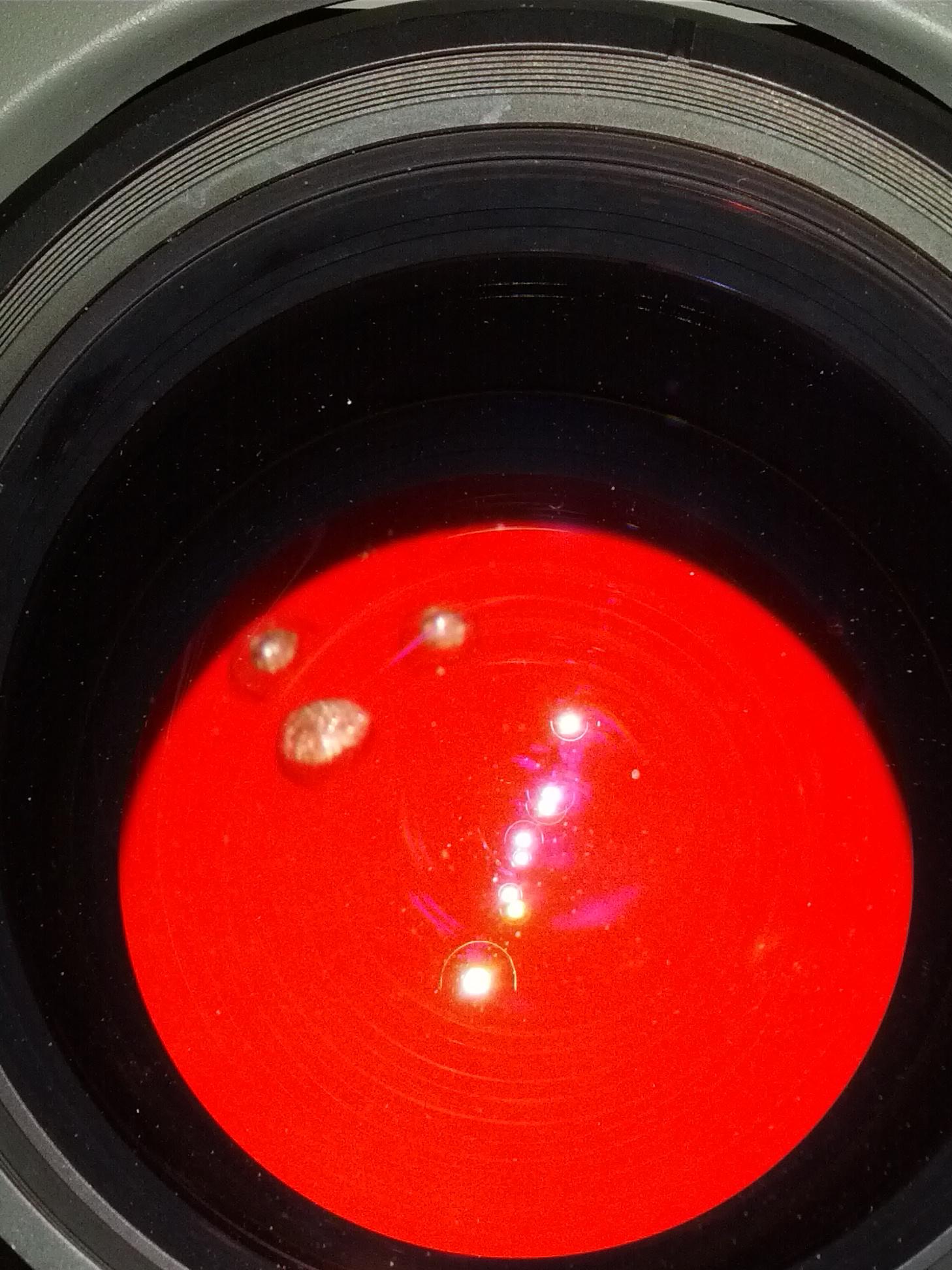

Looks like it may have gotten some direct sunlight in the lenses. Bummer.
| Back to top |
Joined: 03 Apr 2006 Posts: 5180 Location: Buried under G90s
| Posted: Tue Jan 15, 2013 3:12 am Post subject: |
I don't think the odd appearance of the lenses is due to a reflection of what's behind the photographer.
I'm guessing shattered CRT faces. Or worse, if that's even possible.
I'd say "Parts unit!" and not expect to be contradicted.
CJ

After coming across this thread, I guess I will provide all the details. As a total newbie on this forum, this will be the only time I'll ever know anything you experts were unsure about!
I'm the one who bought this G90. I was willing to consider it because of the low hours claimed (In the 2nd listing).
The strange lens appearance in the ebay photo looked to me like reflections. But, I asked the guy a ton of questions and requested photos showing the tube faces. He eventually provided photos looking into the lenses. I detected a defect in the red optics, but I couldn't tell for sure what it was. It was like blotchy whitish spots, all in one small area. He didn't know what this was, but it didn't appear to be on the tube face. I assumed I would need to replace a lens, or something, but I hoped it was a few small chunks of styrofoam peanuts in between lens elements or something like that. The tube faces looked perfect in the photos.
Knowing they don't make these projectors or the tubes anymore, I decided to take a chance. I paid up with "buy it now" figuring that if the hours were true, it would be worth it, and also knowing that I would be able to get a lot of parts out of it to reduce my pain if the worst turned out to be true.
My main worry was shipping damage. My experience has been that things are dropped and banged around excessively whenever anything is trucked. I'm in Seattle, and the projector was for sale in L.A. I figured that the cost of shipping could be shifted, and the risk of further damage would be greatly reduced if I moved it myself. I built a crate and rolled up some latex mattress foam pads and hit the highway in my pickup.
When I got there, the projector looked new in all respects, except for the blotches in the red optics. Those looked the same as in the photos I had seen. We turned on the projector and displayed the menus on the garage door nearby. The hours were as he claimed. And the tubes looked excellent. ( I have a worn Runco 1100, so I know what they are not supposed to look like) So I assembled my plywood crate and placed the machine on top of 4" of springy latex foam that wrapped all around it. I put some soft cotton in front of the lenses and arranged some cardboard to keep the foam from pressing that onto the lenses. The crate went into the pickup on top of soft boat seat cushions. The whole thing was wrapped in tarps, even though the crate was nearly waterproof. I drove gently home avoiding pot holes.
Once unloaded, I gave it a brief power up test to see that it was OK after the 1200 mile trip. I removed the red lens and found small melted craters in the c-element which were what had appeared as spots. These appear to have penetrated less than half the c-element thickness, and there are no signs of glycol leaks.
I gave these melted spots some thought and started to wonder if anyone had done any welding in the home theater the unit had been in. Then I realized that there is sun in California. We only have rain here, but I could see how maybe in L.A. somebody could have allowed the sun to shine into the optics. I wondered if parallel rays from the sun would focus on the c-element. I checked on this forum and confirmed that yes, this can cause the sort of damage I found. I tested this myself by taking a lens from my 1100 outdoors and creating identical craters in an expendable plastic surface. (Yes, we actually do have brief moments of sunshine)
After reading more posts here, I learned about the concern regarding the Dallas chip. I have not been running the projector yet anyway, until the c-element is replaced. So, I'll determine which chip I have as well, before powering it up.
So, I'm not sure yet, but I think I may be OK with this projector. But I do need to find a red c-element.
N

| Posted: Fri Mar 08, 2013 4:11 pm Post subject: Photo of the burned c-element |
Thanks to those who sent PMs. The server will allow me to respond after I put up a few more posts.
To move that along, I'll attach a photo I took of the appearance of the c-element as seen through the lens, and also one taken with the lens off. I'd rather include the photo the seller provided before I decided to take the chance, but it is trapped/embedded inside the ebay message. I'm glad I was aware going in that something was wrong.
Sunlight may be a risk everyone here is already well aware of. After encountering this, it quickly became obvious to me. But the sun hazard had never occurred to me before that. I hope anyone who has not thought or heard of this risk will benefit from what I learned and keep their machine safe.
It's remarkable that some of you were concerned about the condition of these c-elements after looking at the ebay photo. I guess the fact the projector was out in the bright sun was a clue. Maybe the damage happened when the seller was taking the pictures.
