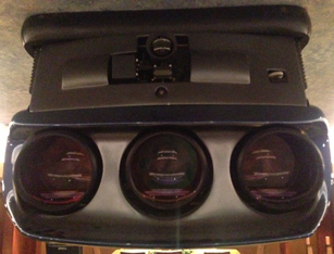

Hello all,
I am new to these forums, this seems to be the best place to seek advice on my rather esoteric question. So my parents bought a new home in 2008, and in the basement there is a home theater section. The old owners of the house set up the home theater around the year 2000 I believe.
For the first year when we watched movies using the projector, there was a slight blue hue on the right corner of the screen, barely noticeable. But over the last few years a green color has started to take over the black areas of the projected image. It seriously hurts the quality of the movies we watch, so for the last year we haven't even used the theater. The old owners of the house told us that we can call some people to come over from Massachusetts who can look over the problem (we live 8 hours away), but I think it might be a huge waste of money considering this appears to only be a bulb problem.
I'm not sure what projector we have, but based on my research I am guessing it is a Vidikron CRT Vision 2 or something like that. Attached are two images, I would appreciate if someone let me know whether I am right or not.
Anyway, after years of use is it normal to expect changes in the colors that are projected? Like I said, there is a very noticeable green shadow around the images projected on the screen. It is progressively getting worse. Is there something I could do by myself without professional help in order to fix the problem?
Any help is greatly appreciated! I know virtually nothing about the world of projectors.
Thank you! Smile

Might just be in need of a simple convergence.
Can you take pics of a screen shot with the Cross hatch pattern showing?
Tun on the PJ and press the # button on the remote. till the cross hatch come up.
then take a pic.

Could it be convergence drift?
Planar PD-8150/Runco LS-5
Posted: Mon Jan 14, 2013 12:49 am    Post subject:
Fungus.
Posted: Mon Jan 14, 2013 2:18 am    Post subject:
With what you're saying, I'd agree with fungus, but yes, post your location, as one of us should be within driving distance that could do a service on the set to get you back up to speed, and update you to HDMI sources if you're not via HDMI cabling already.
Posted: Mon Jan 14, 2013 8:34 am    Post subject:
Nice, you have a so called ACON camera on the projector, it enables to autoconverge the machine, which is of course not perfect, but can keep the machine in usable state, this is ideal for a newb. If you feel yourself handy with tech stuff you can find a lot of help about setting up that projector properly. -> http://www.etechvideo.com BUT before that you should read this: http://www.curtpalme.com/CRTPrimer.shtm this will introduce you to the world of CRT projectors.
Electrohome Marquee projectors (what you really have) are very user friendly, there is a fully guided setup procedure and lots of help built in the machine.
Post pictures about the built in testpatterns as Nashou66 suggested, and we'll see if it is really a color balance problem or simply (mis)convergence.[/url]
