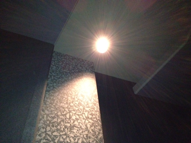

I have always maintained that room color and layout has more to do with contrast than a lot of the specs published with these projectors and a lot of their inflated ratings.
My room is fairly dark by most peoples standards, and I pay for it every time I have to work in it Sad
The screen is a 124" Stewart 1.3 G3 scope, and just received my projector (RS-4810) which I plan on mounting 17-18' from said screen.
On the lower parts of my ceiling I used the flattest darkest paint I could find at the time Benjamin Moore Ulti Matt Black Iron. On the walls is GOM 701 black going out 6' past the screen. While the paint does not seem to affect colors onscreen (probably a little darker than 18% grey), you know there's a ceiling there if your looking for it, which means it will be reflecting on screen as well, affecting contrast, whereas the GOM disappears. The rest of the room, to the left in the pic is the patterned GOM which should not affect color, but again contrast rears its head.
Being as the weakest link is always the downfall of any system be it cars, projectors, or contrast is there even going to be a perceived difference in 99% of rooms going from say 50k - 120k contrast Question
With proper masking a given. In a black velvet room I say possibly, anything less not likely.
Comments?
Oh, and for consideration....
Paint vs GOM contrast
 Filesize:  110.95 KB
 Viewed:  10392 Time(s)
