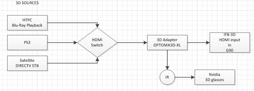

I've been working toward getting 3D playback on a G90 for awhile and recently found a working combination. My eventual choices were taken from other members working systems but I had to substitute for my particular case. The path I ended up with:
[img][/img]
This setup allows 720p @ 120hz playback with decent results but some ghosting on the bottom 1/4 of the picture.IR
I could not get the universal IR emitter to work when I connected it to the Moome card's DIN connector. It appears to do something when I hit the MODE switch on the MOOME remote since the indicator light on the emitter turns on. I checked the IR emitter by looking at it with a digital camera which picks up the IR light and shows it in the display when it's running. I am able to see the IR when connected to the DIN connector on the OPTOMA 3D-XL. I was hoping to use the MOOME IR delay to fix the ghosting.
Is there something I'm missing to get the IR working out of the MOOME card other than the MODE switch?
The other thing that surprises me is that with the OPTOMA in use, I can use the MOOME V2 card and 3D works with that card as well.

I am wondering how to use the DIN connector/IR function on the IFB V3 card? Currently I'm using the IR output on the Optoma. Can anyone tell me how to use the 3-pin DIN connector on the IFB card. Does it work with only certain devices? Is there a jumper setting? I know about the button on the remote to activate 3D mode which makes the red LED come on. With the moome red LED lit, the universal IR sender does turn on it's mode light but there is no IR coming out which I can tell by pointing a digital camera at the IR sender. The camera can 'see' IR when I engage it from the Optoma.

Read Moome's manual closely. One of the HDMI inputs supports Lumagen 3D HDMI protocols and the other takes sync off the vertical pulse. You need to use the HDMI input that uses the vertical pulse unless you are using a Radiance.
Also, some 3D transmitters (and 3D glasses) don't work with refresh rates other than ones used by the projector (display) that they were designed to work with. For example, if I set my XPand 103 glasses to Samsung protocal and then run the G90 at 96Hz than the glasses don't work (Samsung uses 120Hz). If I set the same X103 glasses to JVC protocol and use a JVC transmitter than they work fine at 96Hz.
My favorite combo that I recommend to my clients right now are the Samsung IR glasses from a year ago and this transmitter: eBay auction 150882830472.
This one also works well: eBay auction number 321027849223.

Thanks Craig, very good information about HDMI input providing different support. I'm not sure if I'm looking at the same manual you mention but I didn't see anything about this in the 13 page user manual. I'll have to check it out by trying each HDMI input.
I currently have the Universal Gen2 IR emitter which is made by 3DTV corp. who also make the Ebay 150882830472 so may be very similar but likely puts out more IR than I want. This emitter has a 'mode' button which I set to the 'ORANGE' mode to be compatible with the Nvidia glasses.
The GEN2 is a little weird and doesn't always work as advertised or with all glasses that is says it supports. Then newer emitter that I linked to works with everything I've thrown at it. I no longer recommend the GEN2 now that there are better alternatives.

Taking another look at the manual I noticed the last item in the features table that Lumagen is supported on HDMI1 so HDMI2 would be the one to use. I tried that setup, connecting the GEN2 to the DIN on the moome card but no IR coming out. Could be the thing you mentioned about certain emmiters and refresh rates. I ordered one of the other emitters you recommended. Will those emitters work with Nvidia glasses or are there certain IR glasses you use?
I know it will work with original equipment Samsung glasses. If you get Samsungs, don't buy the generics because they often only work at 120Hz. Seems backwards because Samsung TV's don't support 96Hz, but their glasses do... and aftermarket Samsung don't.

I still can't seem to run the IR emitter from the moome card even with the recommended emitter (eBay auction number 321027849223) and Samsung SSG-2100AB glasses. They work when plugged into the Optoma 3D-XL 3-pin port and it is an improvement over the nVidia glasses but I still get a bit of green ghosting at the bottom of the screen.
I notice that there are 2 lights on the emitter. One lights when turned on and both come on when it's sending IR. I get both with the Optoma but only 1 with the moome card when the moome 3D is turned on and its red LED is on and I'm using HDMI #2. The only thing I haven't tried is connecting a 5VDC power supply to the emitter. It doesn't need one with the Optoma.
Is there something else I need to make the moome work to run the emitter?

It seems to me like you have everything. The Moome card supplies 5vdc for the emitter.
