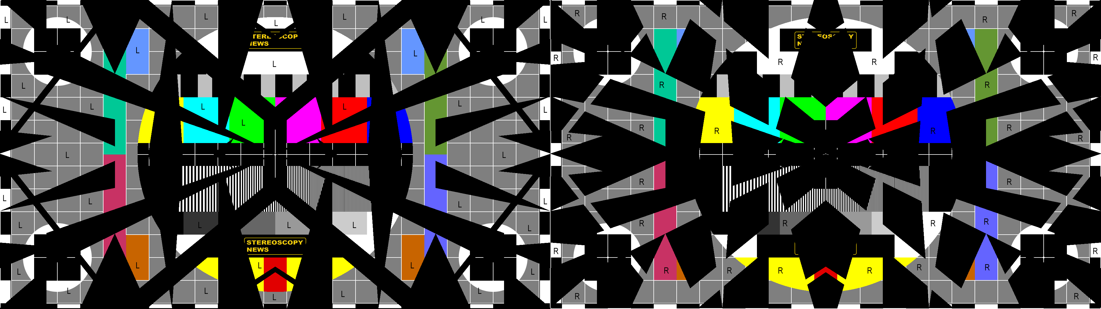

1)...test patter for 3d dual screen calibration:
2)...dual output not via nvidia Geforce 3D vison. On Geforce only until Forceware 162.50 plus streo driver 162.50 and up to 7900GTX/7950GT no SLI and no 8-, 9-, 200-, 400-, 500-, 600 series g-force. But IZ3D or Tridef DDD driver can do the job on PC.
3)@Barclay 66: are you palnning or doing a dual 3d setup? I have a Barco DUET II here....
