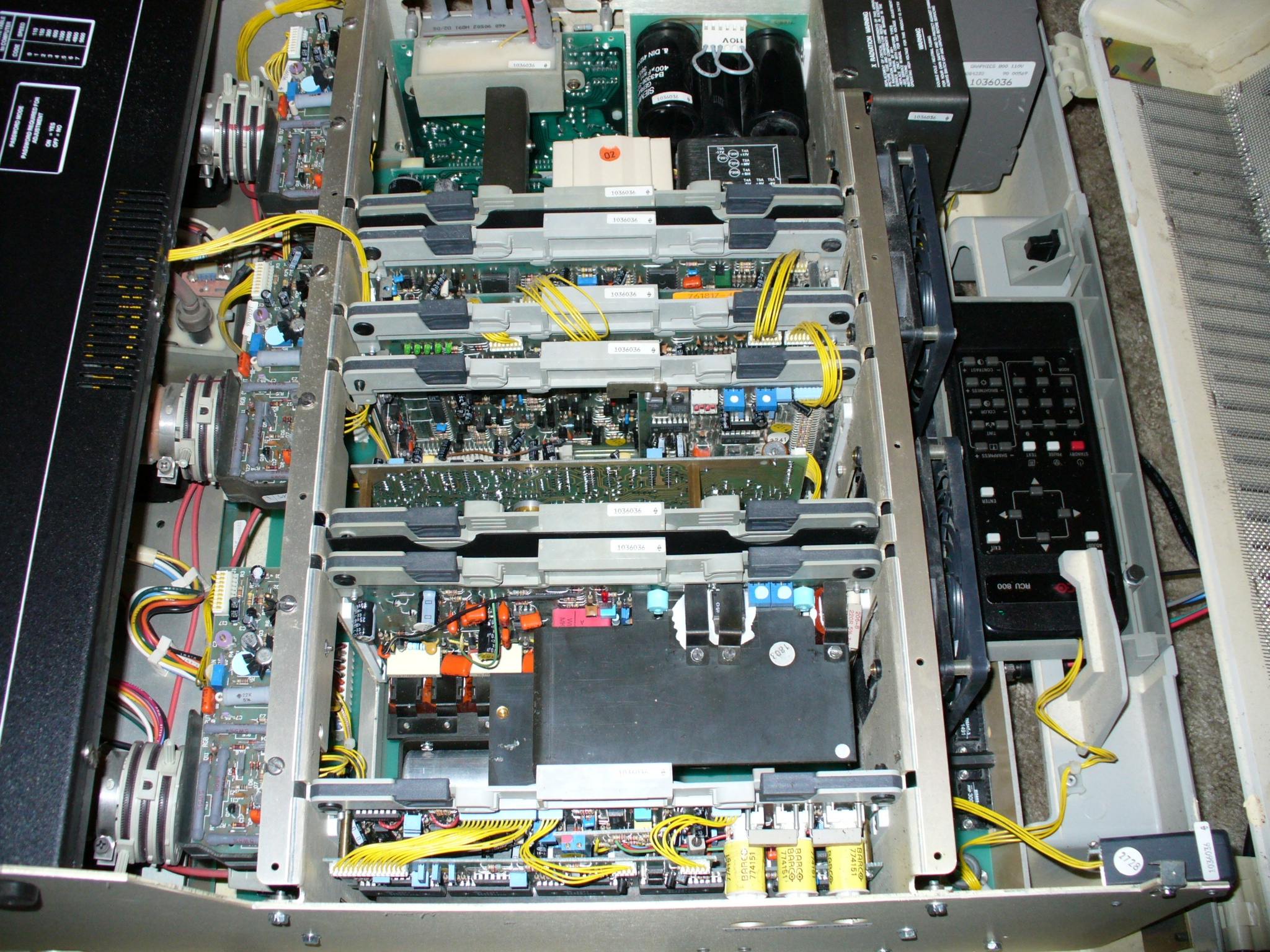

Sounds like the Barco 800 may be suffering from SMPS or EHT issues. Not what I was hoping to determine...
http://www.curtpalme.com/Troubleshooting_Tips_Barco5.shtm
http://www.curtpalme.com/forum/viewtopic.php?p=240625
http://www.avsforum.com/t/643735/probems-with-barco-800-it-doesn-turn-on-anymore
I pulled out what looks to be the EHT board based on this pic:
http://www.curtpalme.com/Barco500_Layout1.shtm
but it looks nothing like the one in this pic:
http://www.curtpalme.com/Barco500_Layout9.shtm
Plugging it back in with the board removed results in no standby power. With the board plugged in, I get the rear standby light always lit (whether the power button is in the on or off position), and any remote key press results in the RCU light coming on for 1-2 seconds, then the error light, then briefly back to the RCU light, then to a solid Processor Cycles light.
Do I go through the boards one at a time and look for a short?

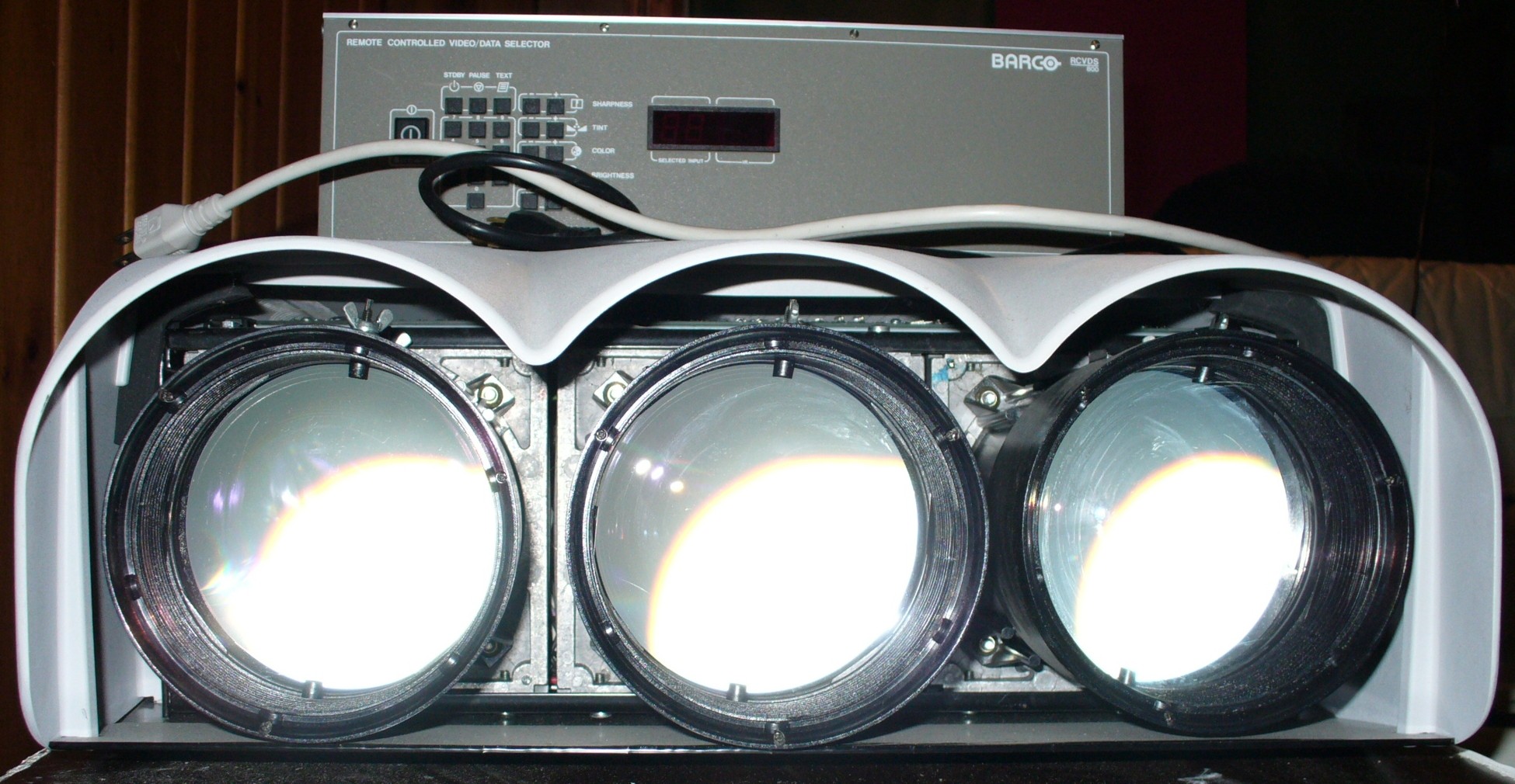

I looked into the Barco lenses with a flashlight and didn't see any signs of wear (the guy said it only has ~250 hrs on it, but then he also said it worked), but maybe pulling them off is more revealing?
Dan
Posted: Thu Dec 13, 2012 4:56 pm    Post subject:
You're probably fine then, you'd see any significant wear, but the lenses do hide it sometimes.

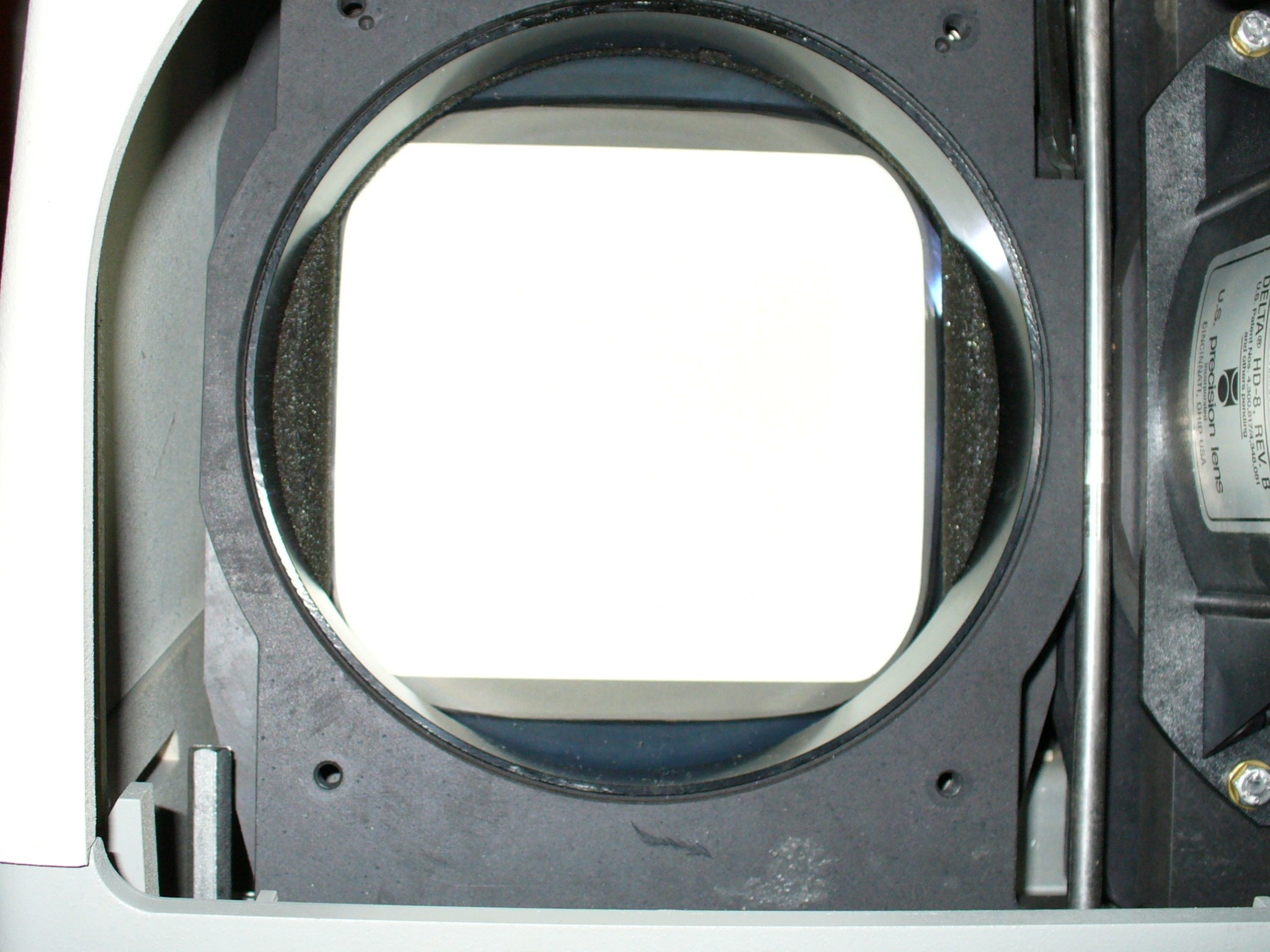

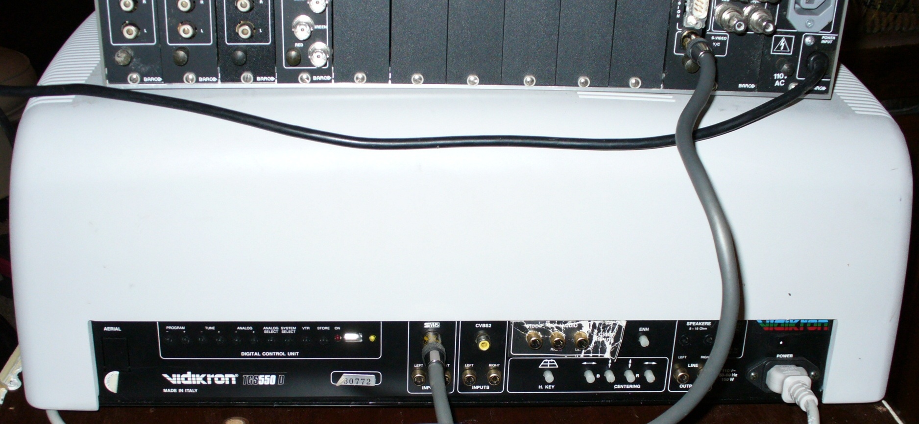

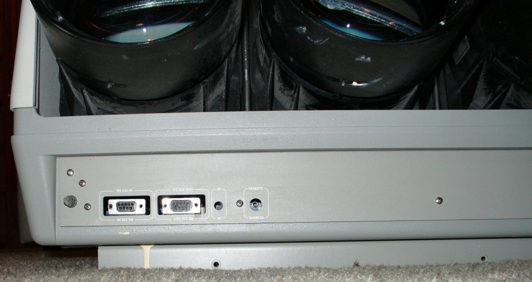

Looks like you guessed right. I took pictures of the blue and green tubes and saw absolutely no sign of wear. If nothing else, what sort of value does the set have for tubes in that condition (plus remotes, bracket, manuals, etc.)? Manufacture date on the set looks to be 1990, so it's presumably one of the late model 800's.
I optimized the pics a bit for the attachment size limits, but I kept them full-size. [edit: I meant to have the main pictures listed first for a more logical presentation, but I guess they attach in the opposite order ... last in, first out.]
Dan

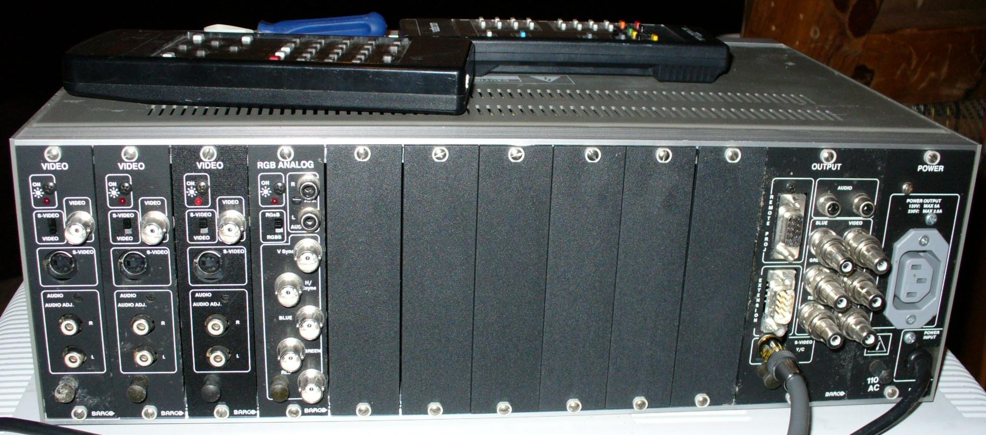

Barco RCVDS 800 Selector.
 Filename:  Barco RCVDS 800 - back.jpg
 Filesize:  252.16 KB
 Downloaded:  325 Time(s)

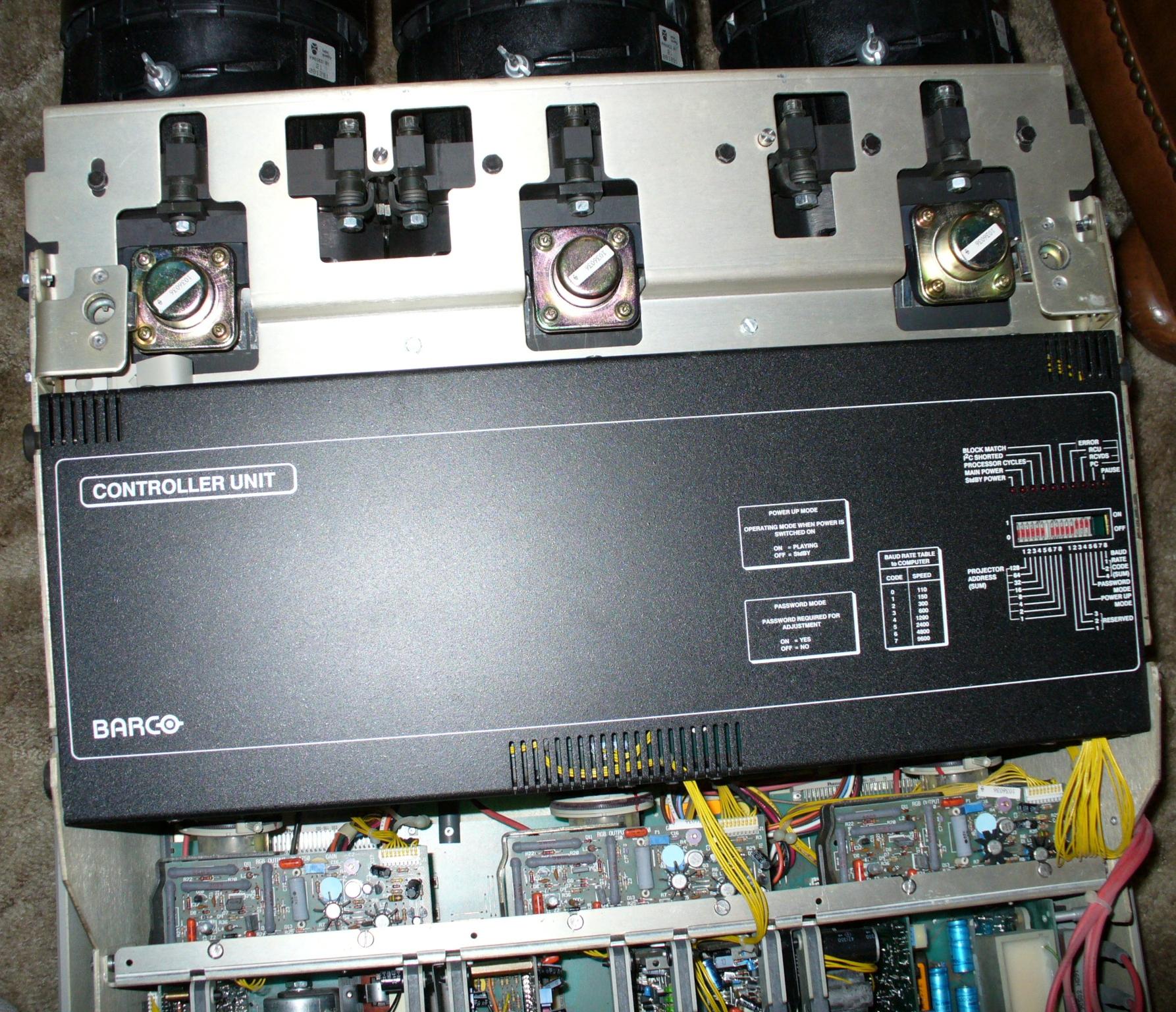

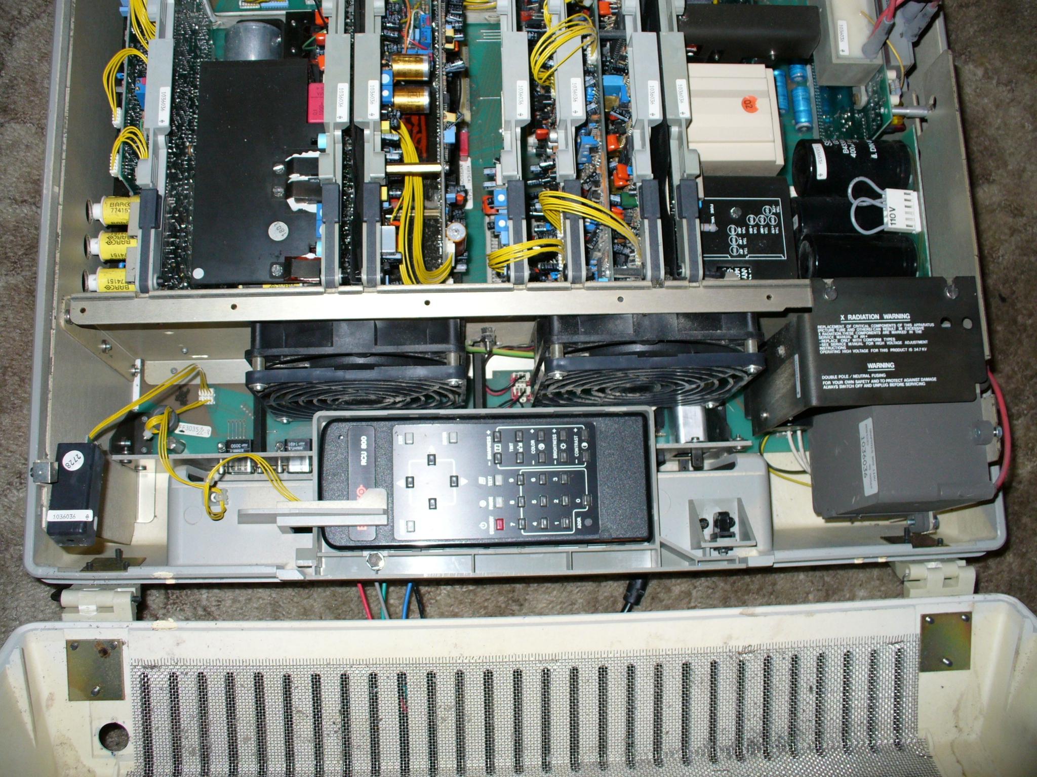

Barco 800 innards.
 Filename:  Barco 800 innards - b.jpg
 Filesize:  488.01 KB
 Downloaded:  316 Time(s)
Barco 800 innards.
 Filename:  Barco 800 innards - a.jpg
 Filesize:  478.55 KB

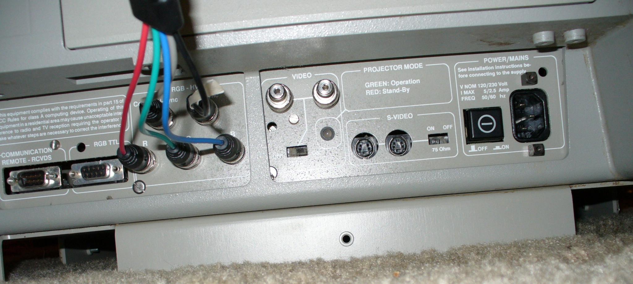

Barco 800 - back panel.
 Filename:  Barco 800 back - a.jpg
 Filesize:  219.54 KB
 Downloaded:  322 Time(s)

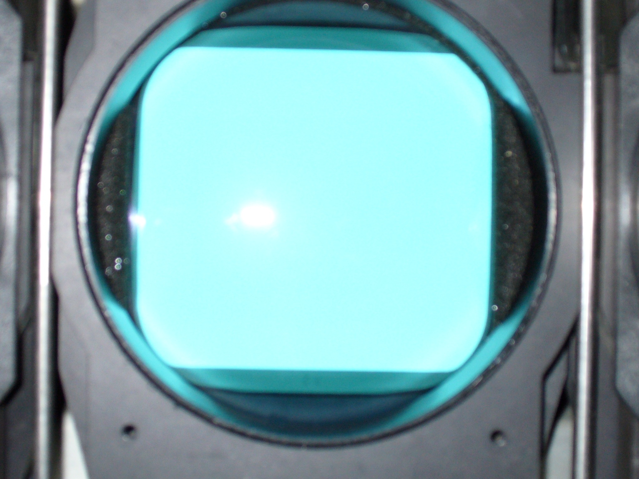

Barco 800 green tube.
 Filename:  Barco 800 green tube.jpg
 Filesize:  450.51 KB
 Downloaded:  347 Time(s)
Barco 800 blue tube, not sure how to get it to show the blue color when unlit.
 Filename:  Barco 800 blue tube.jpg
 Filesize:  421.65 KB
 Downloaded:  308 Time(s)
Posted: Thu Dec 13, 2012 11:47 pm    Post subject:
All tubes are white when unlit.
Posted: Fri Dec 14, 2012 12:19 am    Post subject:
Take pictures of the tubes without flash
dkap
Joined: 14 Aug 2008
Posts: 109
Posted: Fri Dec 14, 2012 12:42 am    Post subject:
I tried that, but it was basically a black picture. My house gets very little direct light, and the theater room is quite dim, so it's flash or nothing. Maybe there's some way to set up a flood light to illuminate it without washing it out, but I lack the photography skills to know.
Dan
Posted: Fri Dec 14, 2012 12:45 am    Post subject:
Dan
The flash tends to hide the wear. Do you have a lamp you can put near by?
Or try partially blocking the flash maybe.
