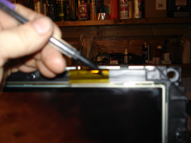

Well after removing a bazillion screws to get the back, outer front and inner metal LCD frame off, I think I found the problem. There is two interface boards (right side and left side). They are part of the LCD panel assembly, hard wired to the LCD panel. Each one has 4 ribbon cables. On the panel end they are laminated directly into the plastic. On the interface end they are soldered, pressed glued or whatever to the board.
In my case I know that it is the right side far right ribbon cable that is causing the problem. Just touching that cable causes a reaction. The rest do not. I do not think the problem is where the cable enters the panel. Touching the cable or pressing the panel where it enters causes no reaction. Touching the cable at the interface shows minimal reaction BUT touching the cable where it bends over the top causes the most reaction.
There is more then data passing through these ribbon cables as they get smokin hot (well perhaps not "smokin" but real warm to the touch). Now that it's been running for a while it is stable and very hard to cause any reaction touching anything. Time to break out the refrigerant bottle. Wink
Posted: Sat Dec 08, 2012 2:45 pm    Post subject:
Here's the bugger

Posted: Sat Dec 08, 2012 2:56 pm    Post subject:
That adhesive as you call it is special stuff where the current only passes directly through it and not off to any side. It requires heat and special tools to apply and the procedure is not cut and dry. Plus the stuff is very difficult to find. Can't remember the name of it off hand but it's probably in my PC somewhere.
I was unable to repair a device Curt sent me where the ribbon was delaminated. I researched the materials and the procedure and then couldn't find anything in smaller quantities. I was going to try to gamble without the special tools but in the end had to bail on it.
Even if it's not delaminated they can sometimes break the trace in the ribbon. If that's the case and the trace is accessible, meaning it does not have a coating over it, you can get a trace repair pen and just draw a new trace. Those are easily available.
Posted: Sat Dec 08, 2012 4:45 pm    Post subject:
"Even if it's not delaminated they can sometimes break the trace in the ribbon. If that's the case and the trace is accessible, meaning it does not have a coating over it, you can get a trace repair pen and just draw a new trace. Those are easily available. "
This is what I think the problem is. I will have to swing the right side board over and see if the traces on the under side are exposed. They are not on the top. Going to try the refrigerant thing first to see if I can exactly isolate the problem.
