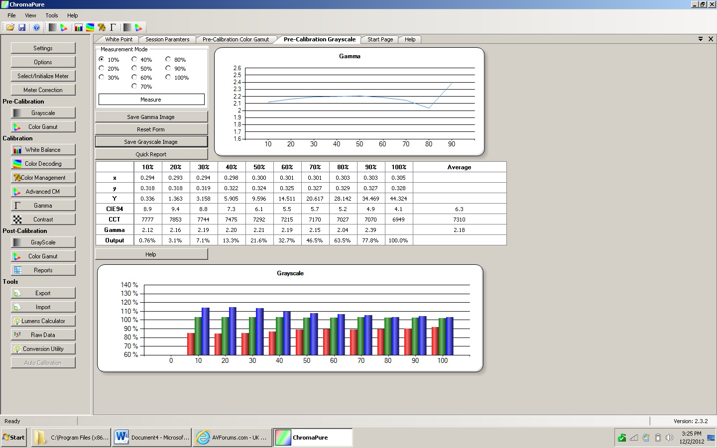

Posted: Sun Dec 02, 2012 2:44 pm    Post subject:
I also just did my first Pre-Calibration on my Sony HW50 digital front projector! So proud of myself Very Happy
I ve attachted a screenshot of the results. I m wondering what this all tells me and what the work there is that s need to be done. I m just talking only about the Grayscale yet, not the gamma and CMS, that s for later or else it is too much for me and I don t understand anymore Smile
Am I correct that the 'Y' shows the cd/m2 values per IRE and the CCT the Color Temp. per IRE? The rest (x, y, CIE94 and Output) I also would like to interpreting the correct way so maybe you guys can tell me what they tell me and how I have to read them?
Am I correct that when I try to aim the Red Green and Blue at 100% the Color Temp. automatically will go to approx. 6500K?
And last but sure not least, HOW do I get R, G and B for all the IREs as close to 100% as possible? I have a R, G, B Gain and R, G, B Bias setting on my projector which are all on their default 0 value now. I would like to know what the best way of working is.
