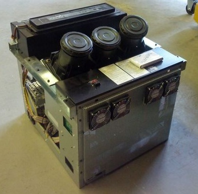

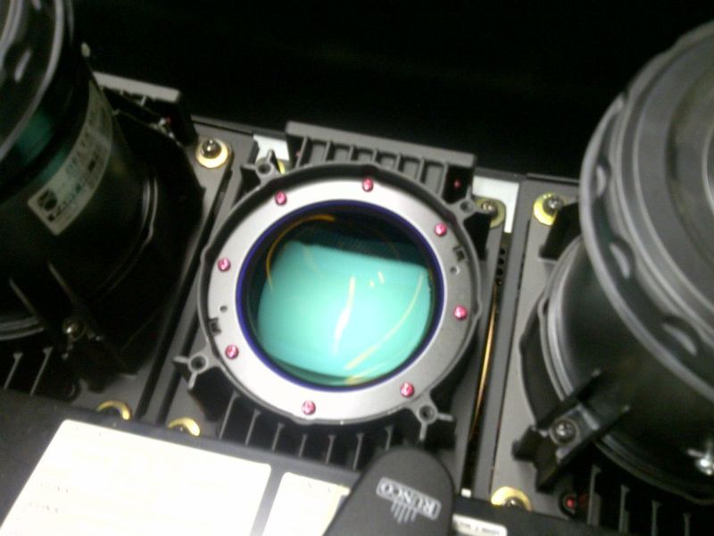

I have a line on a Runco rear projection unit complete. I have asked for the model number but have only been given a serial number. Anyone recognize this at all?
It is an LC unit. So that narrows it down to several models. The LC housings look to be Barco which narrows it down further.
My question if this. Are these split pack units? I appears as if it would only be useable in the rear projection configuration or would need to be put back into a standard case.

I think that's an NEC XGLC unit.

The chassis doesn't look "Barcoish" at all to me. Curt once posted some pictures of Barco split packs and they looked completely different.
What could limit its use to rear projection would be the lenses (short throw and optimum focus only at a short range) and the fixed angles of the red & blue tube. Lenses could be swapped if the C-elements are standard (some RP's have unusual curvatures there), but the angles require modification of the upper and lower rails.
I've been there. Modified a Retrographics 801s to front projection with new C-elements and HD-18 lenses...

Ok, Thanks for the input. I will wait for the exact model number. Doubt I'll grab it though. I was hoping that it was a 9" barco unit and I could salvage the tubes.

I'm saying XG because I don't think Barco 'made' any sets for Runco, and they did have a few XGLC sets by NEC. Also, the round shield plate and ribbon cable look like XG vintage

I was looking on the site under the specs for Runco projectors and there were three Runco DTV models listed as being Barco 1209/2, 1209S and Cine9. The only NEC LC Model listed was the 10PG xtra. With no mention of the XG chassis. That was why I made the assumption of it possibly being Barco guts. As I thought the 10PG LC stuff was rare. You are correct though Curt that ribbon wire is NECish. Are the specs for the RP units different then what is here http://www.curtpalme.com/PJSpecs_Runco.shtm?
Might be a few days before I know the model number for sure. Wish there was a clear picture of the label. There should be a model number on there with the serial number no?
