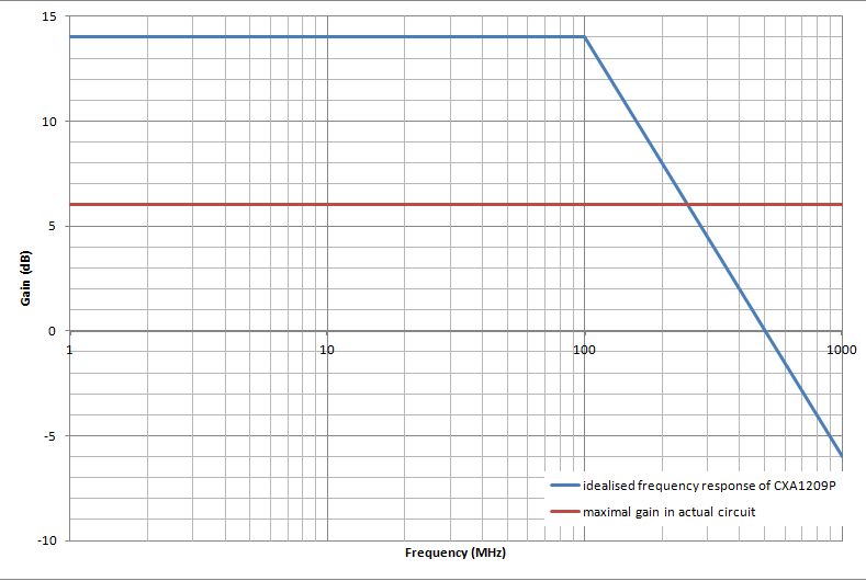

Also you made me thinking about lower bandwidth ICs could go well at higher freqencies. I made some measurement on the actual application of the CXA1299P and found out the preamp is used as a buffer and level controller rather than real preamp, the gain factor is typically less than 6dB. I figured out the bandwidth is meant to be the -3dB point related to the maximal gain factor, also we can assume that the roll off of the amplifier is -20dB/decade as other video preamp datasheets suggests.
I made a little chart. I marked the 6dB line as a guide, in reality the circuit is not driven that hard, more like in the 4-5dB range, but be pessimistic, as you can see the crossing point is around 250MHz.

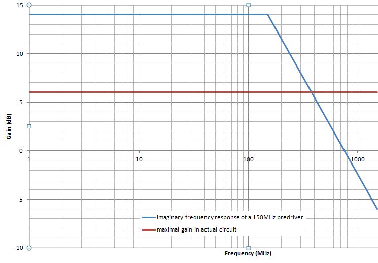

I made an other graph using with a 150MHz BW predriver, in this case the crossing frequency is over 350MHz.
Now It seems to me not this CXA IC is the weakest point of the chain.
CXA1209P response

response with a 150MHz BW predriver (like CXA1779P)

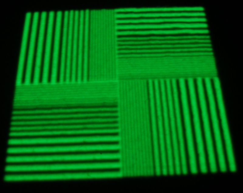

Now I did some realy basic tests.
Resolution pattern in 1080p, the horizontal lines are a touch tighter, than the vertical lines, so the focus is better than the bandwidth -so still not a bad idea to increase the bandwidth.

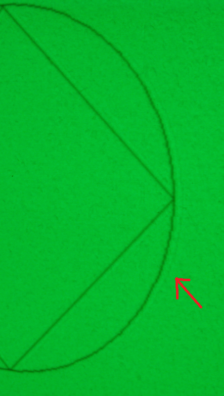

I found some ringing as well, present on all colors. I Ran through the schematics, and found that the video amp has dedicated pin for peaking circuit, it consist of two RC circuit in parallel, any hint how to adjust them toward the good direction
ringing (?) example at 900p-72Hz, NEC 6PG xtra, HD-6C ML lenses

Not quite obvious, but the horizontal lines are tighter than verticals in reality, 1080p 60Hz, NEC 6PG xtra, HD-6C ML lenses

Usually decreasing capacitance will reduce overshoot and ringing.
Increasing capacitance will increase overshoot and increase sharpness.
It is also worth stepping back a few steps from the screen to see if you can still see the ringing. You might be able to see it right at the screen or on the tube face, but with real images it may be ok.
craigr
Thanks, now I can clearly see this from my sitting place, however I only notice this when it comes to full on - full of like on the picture, in a movie I've never noticed yet.
