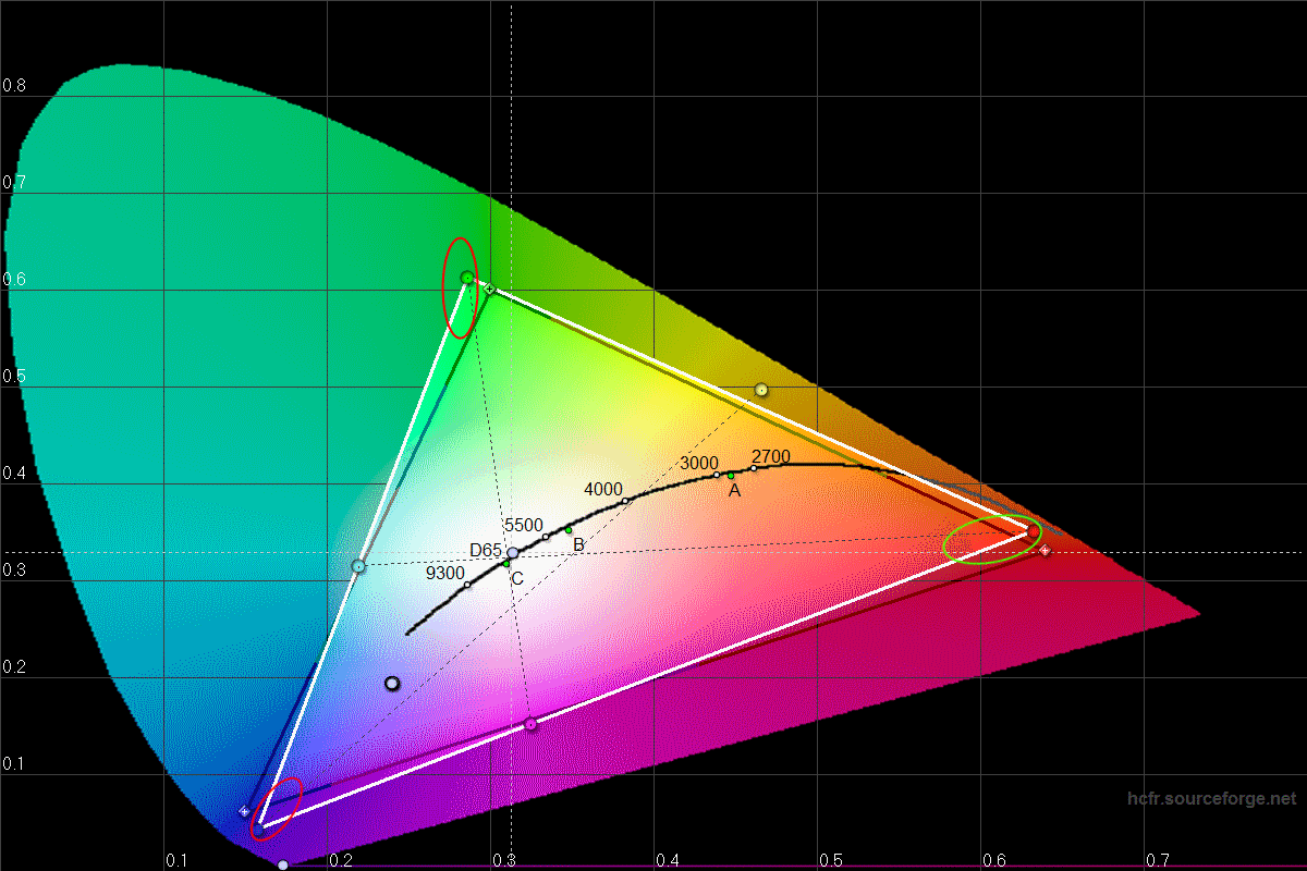

this picture shows the CIE chart after greyscale calibration, everything color-related is set to default, including tint. I've followed your HCFR guide as close as possible, but unfortunately I cannot get the primary colors to move close to their CIE optimum. I've marked the ranges where I'm able to move primaries to, using hue and saturation. can you maybe give me a hint where to put them best, if I cannot achieve the CIE optimum?

Some Sharp sets are notorious for clipping whites early. Most of them have serious color gamut errors as well...serious enough that there may not be enough adjustment range in the cms menu to correct for it. When setting the primary and secondary colors, make sure you use 75% saturated samples.
