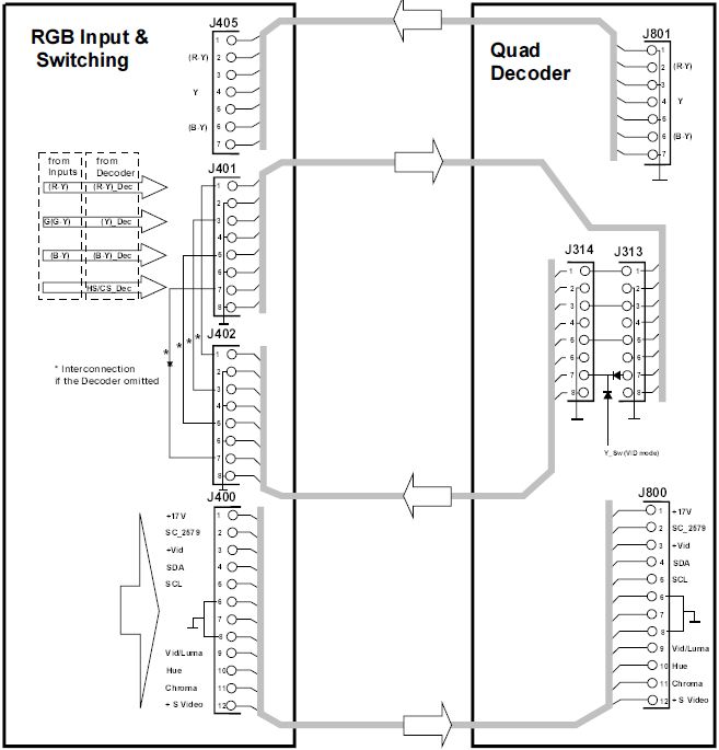

The sub board is called Quad Decoder. It converts Video/S-Video/Component Video into RGB signals. The RGB Input&Switching board will work without it but You won't be able to use other than RGB inputs of course. You need to check if the interconnections on the RGB Input&Switching board are intact. If not You'll need to reconnect them. See the picture for details...
