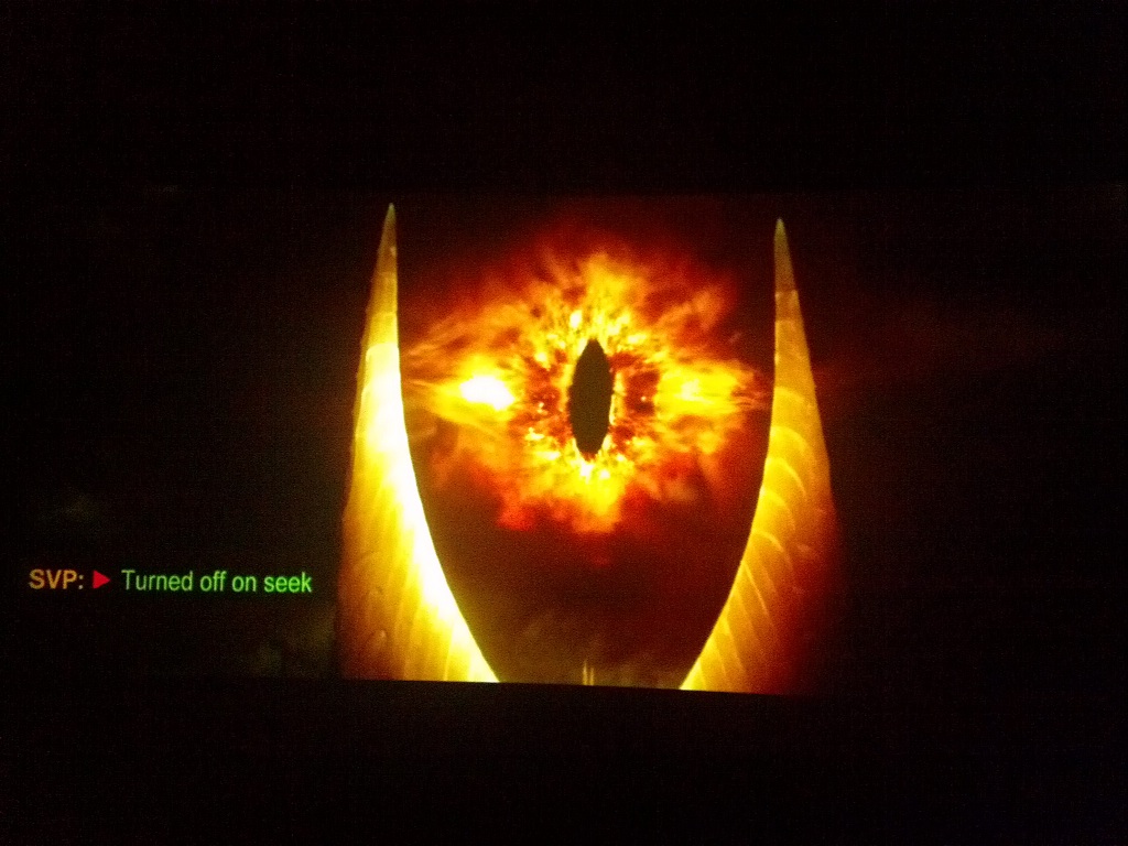

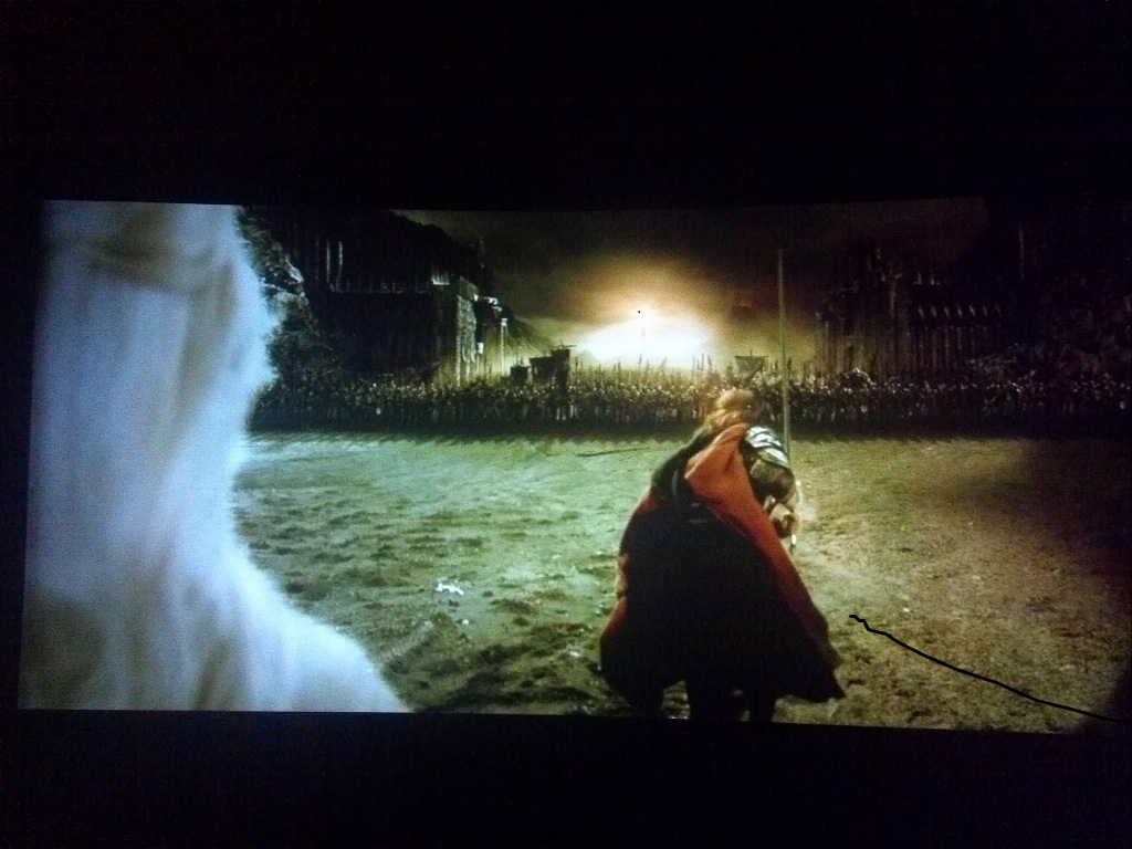

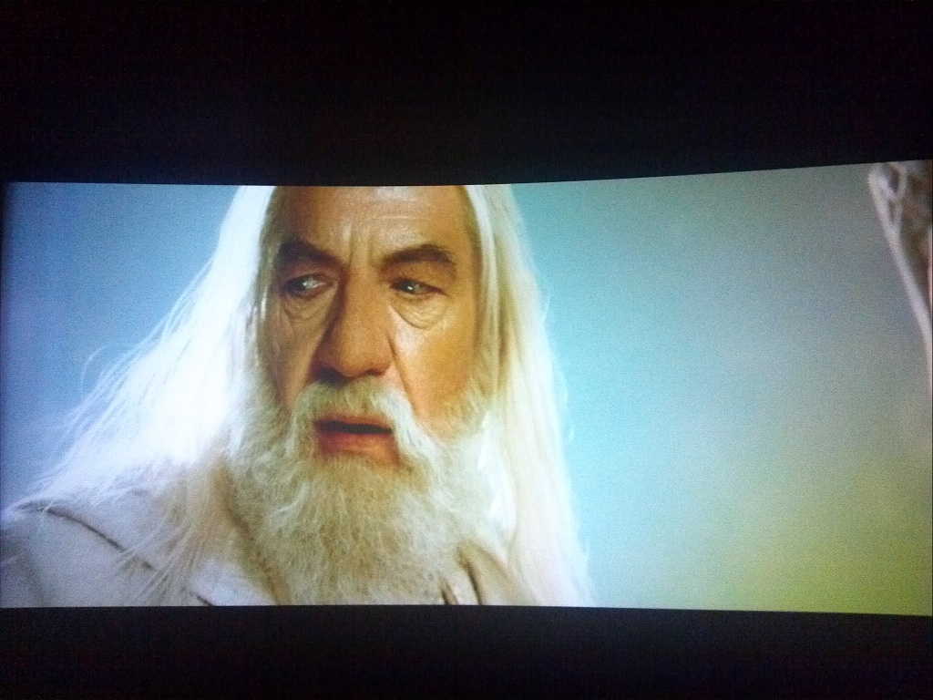

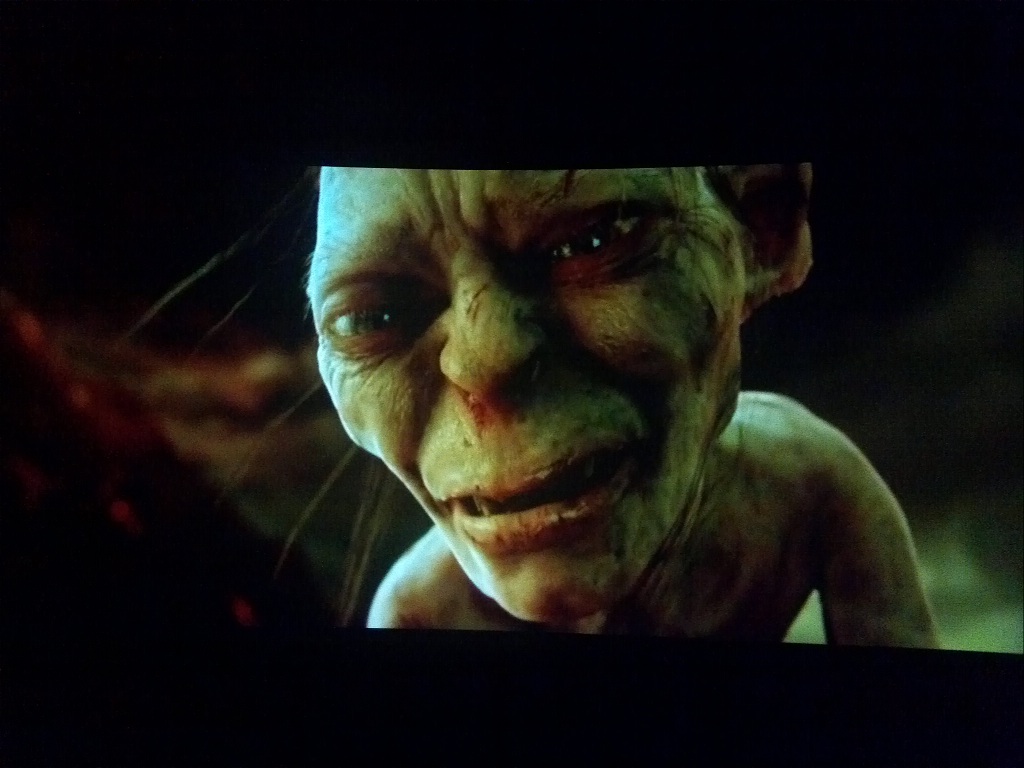

Couple of quick shots from a cell phone on 128" curved screen 1920x800 silver fire 2.0 sony g 70[/img]
