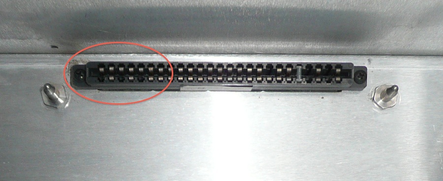

Yesterday I pulled out the LVPS and I heard a piece moving around in there!!
It was one of the screws that fix the PCB to the housing. Imagine what damage that could have done!
Any way I cleaned all the contacts and also the the female connector in the projector.
When I've put everything back in. Bingo! The projector fired up and no focus wiggling around while ramping up the contrast anymore.
I'll attach a picture of the female connector because there are a few pins that I don't know if they are correct.
Could one of you confirm that this is normal.
Thanks for your help.
Regards,
Ron.
