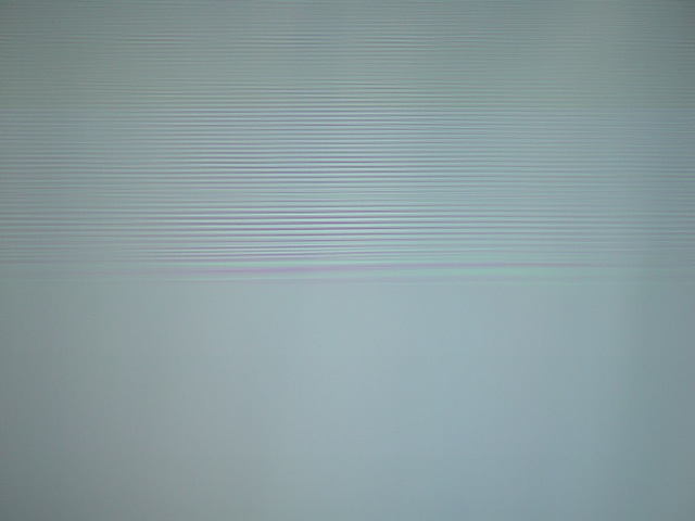

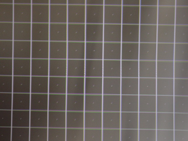

One of my blend PJs went kinky on me; this happened ice cold at power up; I cycled the power and it was okay for 20 minutes then the distortion returned and would not leave. It looks like the convergence is dancing around, bunching and spreading, maybe just on green?
Anyone seen this?

Reseat the chips on the CLM/DPM.
