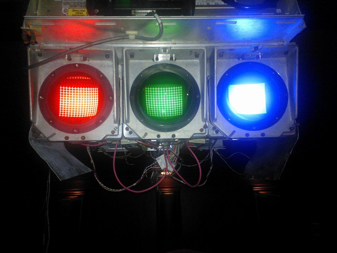

Ok so I re-did the HV leads to each tube and I have the entire thing back together. Now I have another problem with the blue tube. It lights up but has no image. Attached is a picture of what it looks like with the grid pattern displayed. I have a spare PJ and hace replaced the below parts with no change:
Blue Neck board
HDM
Focus Board
Mini RCA cable to Blue Neck board
Any suggestions?
[img][/img]
Grid
 Filesize:  185.35 KB
 Viewed:  6504 Time(s)
Posted: Sat Sep 08, 2012 11:52 pm    Post subject:
Hello
Did you turn blue drive way down? Drive should be 30 to 45. Also, move the mini coax from the green neckboard onto the blue neckboard; lower the contrast to 30 for this.

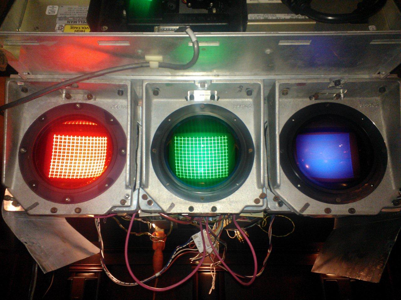

So I went down to switch the RCA mini and turned the PJ on to lower the contrast. Voila, the blue tube turned on and showed the grid. But it seems way too bright in the background. I don't have a lot of experience looking at these with the lenses off but there is not much contrast between the grid and the rest of the tube face. The attached picture shows what I mean. I just replaced the battery so the settings should all be default.
Barely see grid
 Filesize:  138.02 KB
 Viewed:  6493 Time(s)
Posted: Sun Sep 09, 2012 1:36 am    Post subject:
Hello
Your G2 setting for blue might be too high, that is okay.
Put the cables back where they started, and try a gray scale setup for 6500K as described in Tech Tip One: http://www.etechvideo.com/techtips.htm
