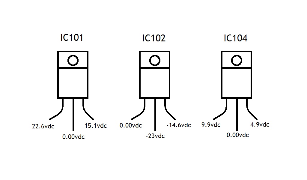

Disconnecting that connector should eliminate the output section. You will have to check the regulators on that board. IC104 = +5v, IC101 = +15v and IC102 = -15v. I'm guessing the +15v reg bad.

Posted: Fri May 25, 2012 4:12 pm    Post subject:
Interesting, so your saying that the power supply section could be the issue and not the output chips? I'll check those ICs out and get back to you mac, thanks Smile

Posted: Fri Jun 01, 2012 1:31 am    Post subject:
Mac,
Sorry it took a week to get back to this, I'm pretty busy around here and have been trying to get back to this, I finally have a few days to do so.
heres a pic I made of the ICs you told me to test, I'm not sure what pins were the E C or B so I made a visual :p

Posted: Fri Jun 01, 2012 1:34 am    Post subject:
Also the pic is showing the chips as the fronts of the chip
Posted: Sat Jun 02, 2012 12:14 am    Post subject:
Those numbers look fine. Guess this one is going ot be tricky.
