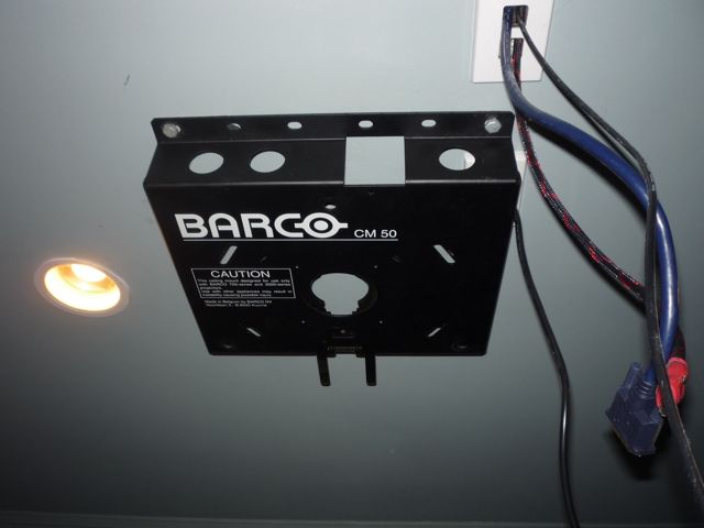

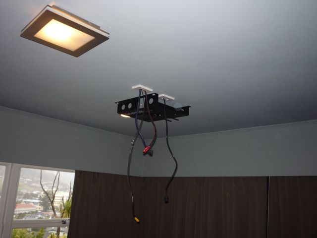

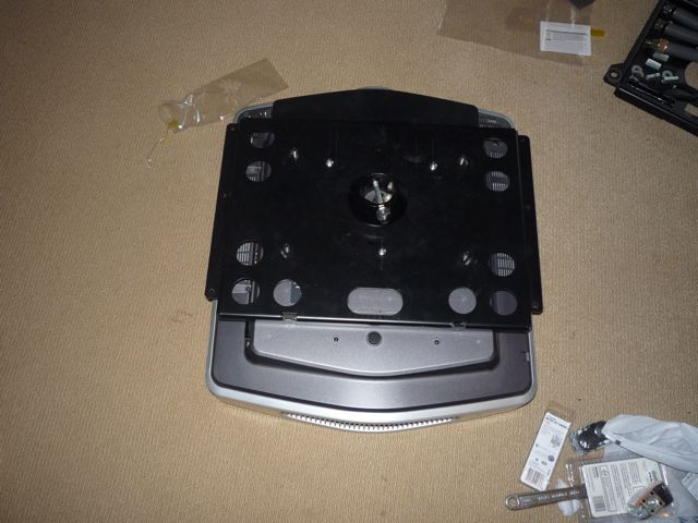

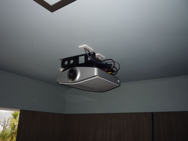

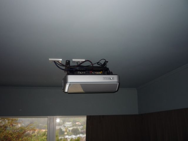

i customised a barco cine7 mount for my ruby

Posted: Thu Nov 22, 2012 1:13 am    Post subject:
Ha, ha I like the Barco mount for the Sony. I just reused the uni-strut I had my Sony CRT projector hanging from to mount my JVC RS40U. Needless to say way overkill for a ~40lb projector. Smile
