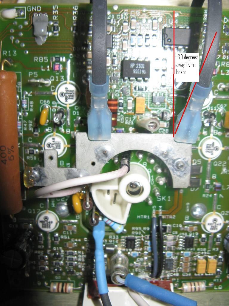

make sure the 2 big black wires that go the neck-board are making a good connection. Clean with de-oxit and make sure they are tight, not loose and wiggling. There carry a lot of static from the tube bell and will cause the noise your describing. Also bend the 2 tabs back towards you with needle noise pliers. This a VDC tech bulletin to reduce noise from the wires. Make sure the card is well supported so you don't stress the tube pins or take card off tube

I swapped the Red and Blue RCA connector cable on the board, watched a movie...and yep...problem was still present in Blue
SO, must be th neck board. Took it out re-tightned and cleaned all the connectors...watched a film yesterday an NO PROBLEMO anymore! Thumbs Up
