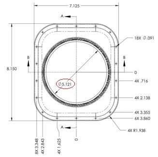

When I mounted his bellows on my tubes I used a very thin layer of RTV anyway. So You might call me anal too. However I noticed that the surface which would seal against the C-element didn't fit perfectly and initially leaked without RTV. This was due to the fact that the aperture in the housing was a little wider than the bellow ring facing the C-element (see picture, I'm talking about that diameter of 5.121). When mounting the C-element the Bellow could slip off the housing due to friction with the C-element. In this case the layer of RTV did not only act as an additional sealant but as a lubricant too. The C-element widened the rubber uniformly and thus fit like a glove.
BUT: I'm talking about a thin (!!!) layer between the bellow and the C-element and not about RTV between the housing and the bellow!

Oops, forgot that picture:
 Filesize:  26.28 KB
 Viewed:  4640 Time(s)
