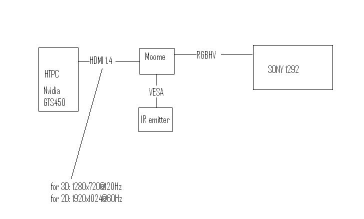

Posted: Thu Apr 26, 2012 9:25 am    Post subject:
Here is my configuration:
I have also tried with 100Hz for 3D not a difference on my 1292. Unfortunately I have some ghosting issues at the bottom of the screen with the green tube. Every attempt to reduce this (changing the porches, frequencies, etc.) didn't really worked fpr me. Do you have any ghosting on the NEC?

Posted: Thu Apr 26, 2012 11:31 am    Post subject:
No mate, zero ghosting at all, maybe try a lower refresh and see if it goes away for you??
