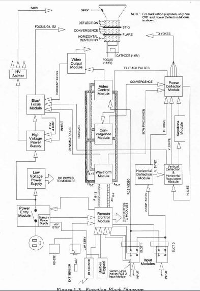

BTW, the function block diagram for the ECP (attached) is really nice -- Is there a similar overview schematic for a high-end 9" machine. The G90 theory of operation is VERY clear for sub-components and the video/sync chain, but does not provide an overall system schematic. I looked around (quickly) at various manufacturers 9"units and didn't see anything. I was hoping to try to do an overlay of sorts so I could see what sophisticated layers were added to my "simple" machine's circuitry. You folks said ECP was a great place to start learning...!

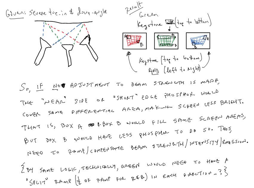

Chris -- Thanks for weighing-in as well. I think I'm having a hard time expressing my thoughts. I've been holding off replying as I want to see if I can get this out so you guys can set me straight! I understand the ramp is applied not to compensate for uneven wear -- it is applied to make the on-screen image correct. I considered the ideal case of Mac's hypothetical constant, full-white screen...
1) Goal: the PJ should be able to display a uniform intensity white image over the entire projected surface.
2) Problem: the R&B tubes "toe-in". IF the beam swept with a constant gain over the phosphor area, the luminous emittance would be constant. As such, one would find the on-screen illuminance would be non-uniform due to the fact that unequal areas of phosphor transmit to equal areas of screen...i.e., keystoning the image on the tube face is required.
3) Fix: apply a gradient or ramp to the beam strength/gain as the beam sweeps from edge to edge of the tubes. For R&B, these would be of opposing signs (increasing R to L in one, L to R in the other). Point being, the phosphor on the tube face does NOT have a constant luminous emittance to insure the illuminance IS constant.
4) Implications: one side (and I suppose the top and bottom given all tubes equally keystone vertically) of both the red and blue tubes is always driven a little harder than the other side. Thus, shouldn't the tubes' phosphor wear unevenly on their faces? And if not, doesn't this imply the need for accounting for this is -- under correct/normal installations -- not significant or detectable by human visual acuity?
Attached is a sketch I made in my notebook for myself, but maybe shows my thinking a bit better (the text in the image does not). Again, I feel like I must be wrong on something obvious, just not seeing where it is. Embarassed OR possibly this is a really minor effect that a design engineer worried about when he/she really shouldn't have bothered. Help!

Yes but I think you have the A and B backwards. (I love the drawing btw!)
I'm a little confused because I don't know if the trapezoidal drawings is looking into the lenses (backwards-oriented) or what it would look like at the screen uncompensated.
But I do think you have it backwards because the near side uses MORE phosphor, and is brighter. The FAR side uses less phosphor and is dimmer. That's why you have to do the trapezoid compensation to shrink the far/opposite side down.
Here is the section I remember from guy's writeup:
If you happen to know your center cross pattern is already precisely centered you can just use the center cross to aim the tubes. Unfortunately, the most accurate way I know of doing that is to pull the lenses off, center the cross on the phosphor while measuring with a ruler, then remounting the lenses. The white field pattern edge comparison method described above allows easy, accurate physical aim and centering on the phosphors without pulling the lenses. This also gives a subtle plus for the red and blue guns as I'll explain later.
I know this method seems backwards, but balancing the edges of a white field pattern against the edges of the phosphor and then the projected edges relative to the screen edges achieves precise mechanical aim in an easy manner. The advantage to this method is basically the difference between having someone mark the middle of a piece of paper without aid of a ruler vs aligning a slightly smaller piece of paper so it is uniformly spaced inside the larger piece of paper. The latter is easier to do accurately.
Consider the off center red and blue guns. If you aim the actual center of the phosphor of those tubes to project at the center of the screen, you'll note that the phosphor usage distribution is unequal left/right due to the throw angle. Graph it out and you will see that the farther half of the screen gets illuminated with a smaller area of phosphor. Ever notice how the side of the screen opposite the side of the gun is less well focused? This is part of the reason.
Centering a field pattern relative to the phosphor and then using those lit up edges to guide lens aim will actually place the red and blue guns so they are mechanically slightly off true center. The left lens ends up pointed slightly left of center and the right lens ends up slightly right of center. At first blush, this seems wrong, but this can actually be advantageous because it makes the raster usage, resolution, and illumination more uniform across the screen. Less horizontal linearity compensation and lens flapping are needed.
Now, what's interesting to me is that I had *no* idea that some projectors attempted to compensate for this by ramping the luminance up a little bit L/R or R/L on the outside tubes to help out with this very issue!
As far as the wear question goes, I think the difference in light output from the ramping would be pretty minor, and really would have no appreciable difference in the wear. I think the content variation would be way way more significant, and that ends up being pretty random. In other words, for you actually to see anything significant in terms of one side of the tube wearing more than the other because of the ramping, you'd probably need to rack up hundreds of thousands of hours (just thumb-in-the-wind guessing) for that ever to be noticeable, in which case you have bigger fish to fry in terms of wear!
So when I set things up, I'm never usually super terribly concerned about the tube swing for the outside tubes, but I usually split the difference somewhere between aligning the center cross, and the edges. That usually seems to work out the best, and drives the geometry and convergence the least. If you swing sharper angles to align the center of the tubes, you end up needing a lot of geometry adjustment and you can run into the light output fad-off on the far side as we are discussing. But if you go totally the other way and try to align just the edges, then you end up driving geometry/conv pretty hard in different ways all over again. So usually somewhere kind of in the middle seemed to work out the best for me. It's the guessing-game of CRT setup that I like to pretend is really some kind of high "art." Thumbs Up
