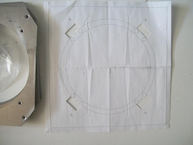

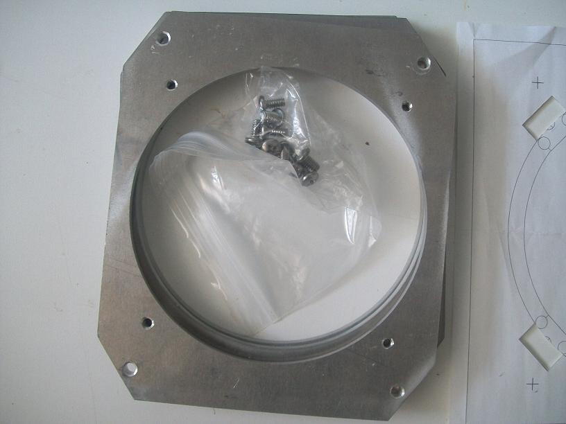

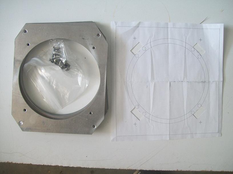

I bought these adaptors from one of this site members (are they Joust??), Can someone guide me to instructions to attach 144 lenses to an Electrohom 8500. Should there be some other spacers or something? thanks.

those are the old style and require the lens mounting plates to be removed and notched at 4 locations. IT's 1/2" thick aluminum and poeple here have done it with hand tools. I use a milling machine and can do it for 20 bucks + ship if you get really stuck.
Posted: Mon Apr 09, 2012 7:23 pm    Post subject:
I used a large Drill bit in a drill press. then a File to flatten the point the drills created. Took a bit more time but worked very well. I actually like it better than the new mounts.
