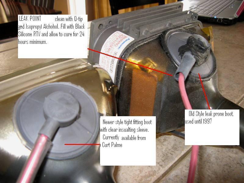

it always "seems ot be coming from the splitter" because that black sooty grime on the HV wires is conductive. The leak will start at the bell of the tube, then travel up the wire and arc to the card cages or lens mounting plates. you can certainly put as much RTV silicone around the splitter as you want.
When your done with that take the plastic covers off the tubes and see if any of your boots look like this.

Posted: Sun Apr 08, 2012 9:50 pm    Post subject:
Hello
The clear tubing is more to prevent cuts of the leads on sharp edges than anything else; PVC has little insulating value at 35000 volts. Look for a dark pin-hole spot on the pink wire. If the leak is on the HV supply lead then you may be able to shorten it a few inches and reattach the Hobson connector.
