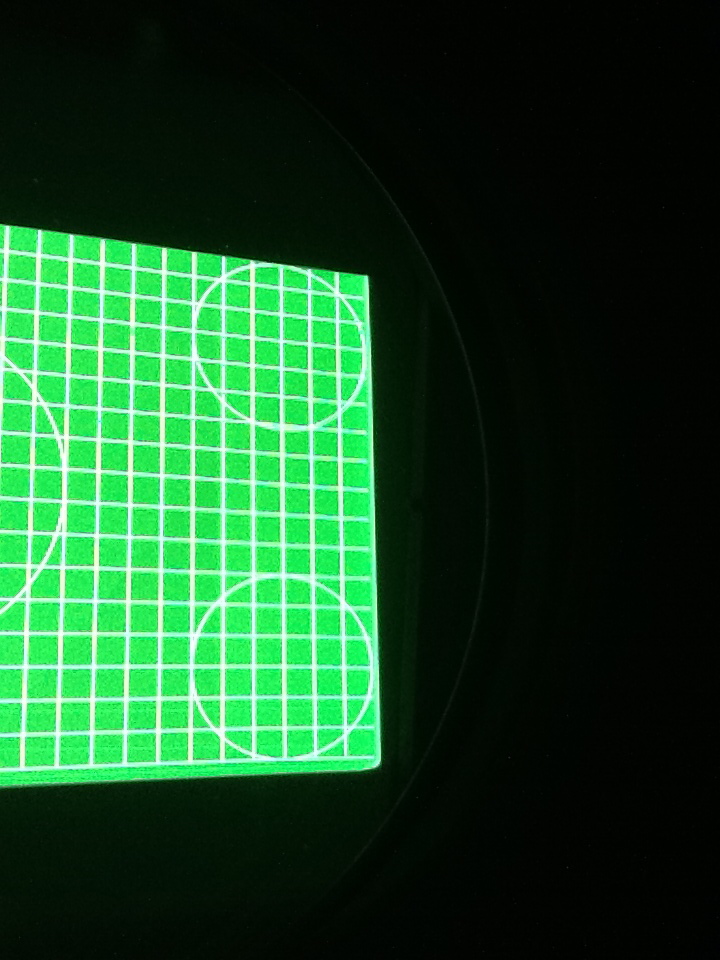

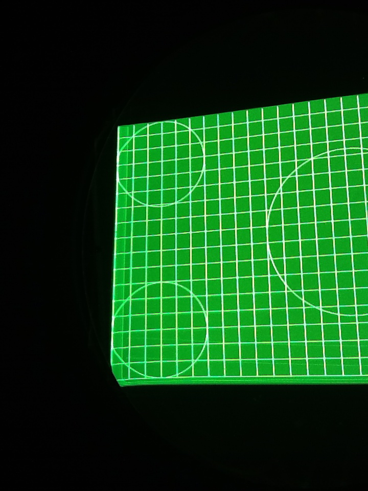

Chain = PS3 > Moome IFB-FULLHD v3 > G70.
(ceiling mount) Folding and distortion on the left side.
Moved image to the right as much as I can without cutting off the image.
No problem with lower resolutions.
Any way to solve this without resorting to a VP?

Does the Moome have any porch adjusting capability?
If not reduce image size and shift off center. Similar to other PJs that shift the raster off center.

The moome has image shift but I don't think that is going to help me.
Is there a way to expand raster and contract image?

Nope. That did not work.
I guess cause I have no Raster left.
When I reduce RGB Size, the Image gets smaller along with the Raster.
Image wrap remains no matter what size I make the Image/Raster.
Why would the Image be larger that the Raster anyway?
Why is the Raster not automatically larger than the Image as in the lower resolutions ?
Is there a way to resize the image independent off the raster ?

The SIZE key is what controls raster size.
RGB SIZE is the active image.
You want to increase raster (SIZE) and try decreasing image size (RGB SIZE) to compensate.
The raster-wrap is the projector starting to draw the beginning of the scan line before the beam has returned to the beginning of the scan. This happens when the front- and back porch (horizontal blanking interval) gets too small. The Moome must have just enough smaller porch the the G70 won't handle it like the 1080p from my HD Fury.

What I always do on a G70 when I hit this problem is to apply blanking to the left and right sides to cover the bend in the image. After that, center the image in what's left of the usable raster space and move on with your setup. You will now have some overscan on the sides, but it's not a terrible amount. Increase the height of the image and apply blanking such that the overscan is equal on all four sides.

I did notice that it is not the image that is wrapping.
The image is full.
It is the raster itself that is wrapping and creating the line shown on the left of my first pic.
