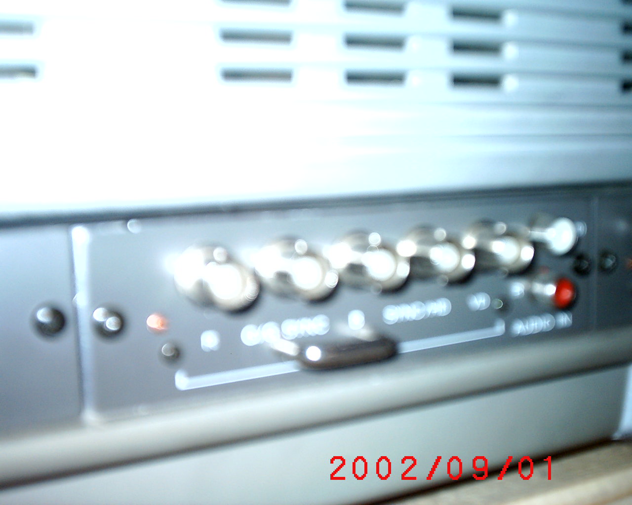

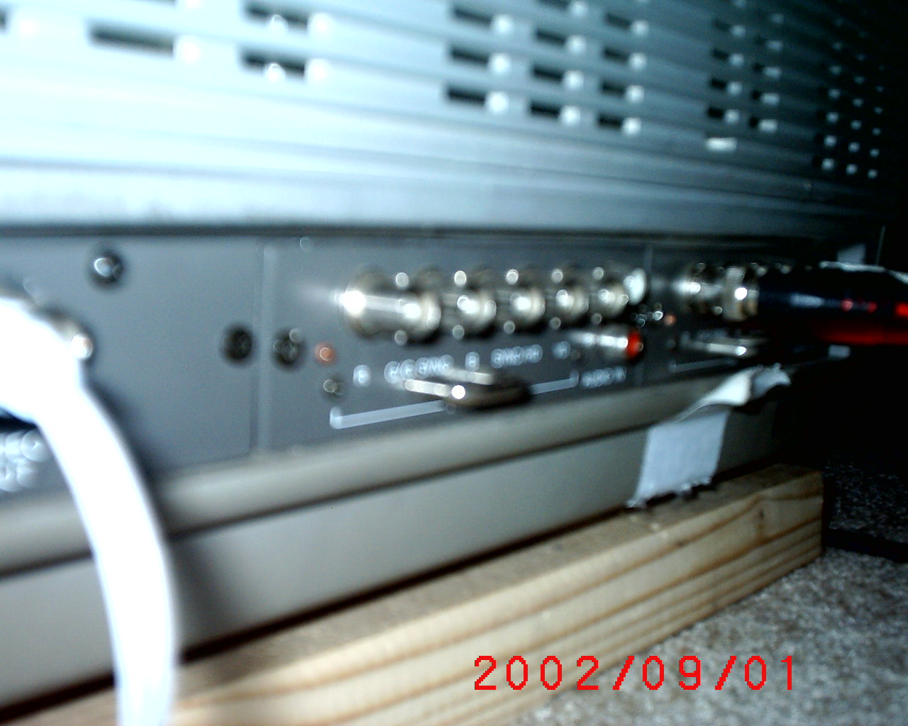

I have a Sony 1270Q with two IFB-12 cards. What is the best way to connect my Wii system to this projector? I have the YPbPr cable for the Wii.

The 1270 will not work with the IFB-12 cards I'm afraid, so you'll need an external component to RGB converter box.
Sony made some circuit or production changes with every other 12XX set that would let you mod the IFB 12 cards to work with a component signal.

Thanks and one in particular you recommend? I take it I can use a VGA to BNC adapter from the box to the PJ?

I use one called HD Box Pro, I think. You can get them cheap on eBay. It works great for PS2 and Wii. It also deinterlaces and upscales, so it's better than running 480i/p into the projector anyway.
