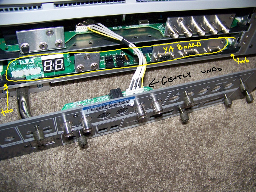

Can someone tell me exactly where the YA board is in the G90?
Posted: Sat Mar 24, 2012 12:48 am    Post subject:
Right under the RGB board in the back.

Its the one with the LED daughter board attached. Unscrew the backplate and the YA slides out the from the back.

For reference, I'va attached a marked-up picture I made for myself so I could have people on ebay look at the IC421 for me. IC421 is easy enough to find on the board.
Matt
location of YA board
 Filesize:  311.32 KB
 Viewed:  3776 Time(s)
