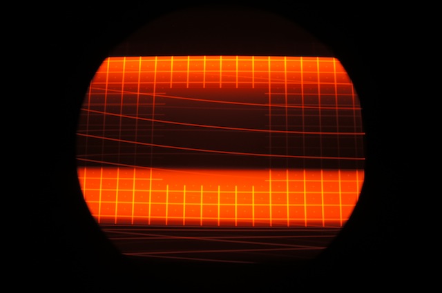

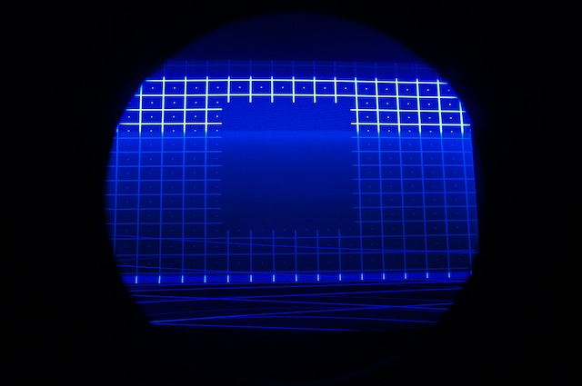

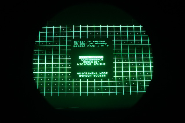

I finally got my Barco Cine 7 repaired, the focus block got replaced as it was faulty and there was no image being displayed. However, I have some problems setting the projector up properly and might need some help from you guys.
If you look at the photos I've attached, my problem is that the RED and BLUE tubes are too bright and I'm not able to correct that. When I look on to the face of the CRT's, on the GREEN tube, only the lines and dots are visible, the rest (background) ist pitched black. This is not the case for the BLUE and RED tube unfortunately. I believe on the RED and GREEN tube, only the dots and lines should be visible and the backdroung should be black.
On a side note, this is the internal test pattern of the barco cine 7, I have no source attached to it.
Can someone let me know what I need to adjust in order to get his set properly?

Looks like the G2 needs to be adjusted on all three tubes.
It has a combined focus and G2 block, so after replacement focus and G2 needs te be re-adjusted.
